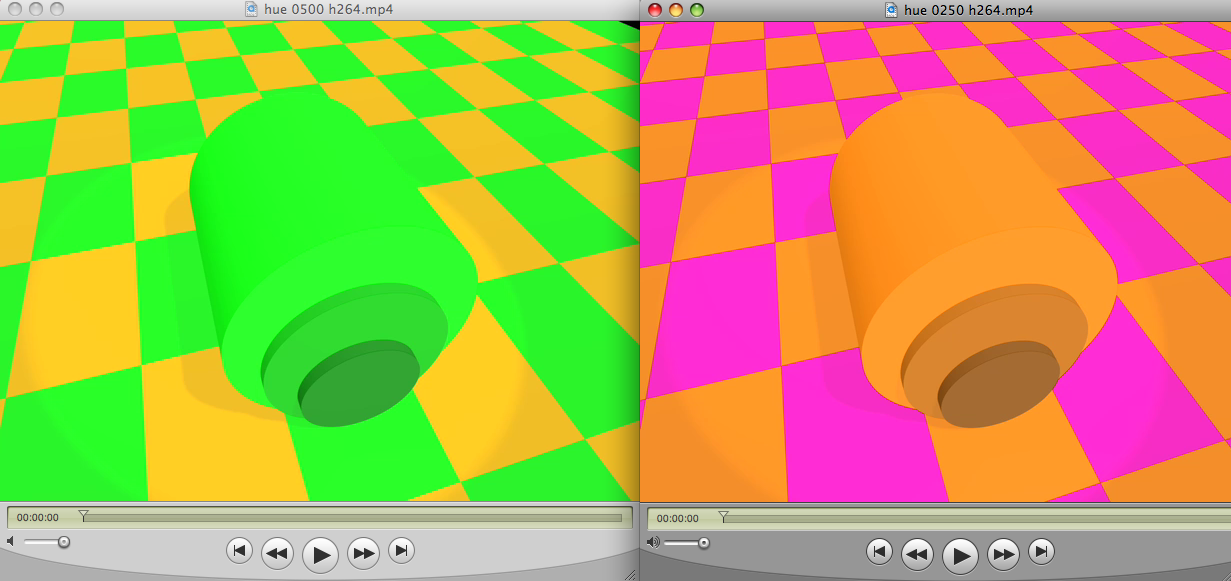

Ok, attachment "hue changes and h264.png" shows something interesting:
• in blender (open-source 3D app) I have a nodes system, a bit like in Shake. When I change the hue factor to its half (0.250 instead of 0.500) I get of course the wrong colours, but the H.264 encoding almost works as you would expect! Only "almost" because the rectangles on the floor from the wrong coloured one (right side) still are not ideal, but much, much better than the ones in the original (left side).
I also tested other hue changes and found the more it gets towards 0.250 the better it gets. All other changes (less than that or more than 0.500) also give different results, most seem better than with 0.500, but the best value for hue seems to be 0.250. And the worst results happen to give my original colour combinations with hue set to 0.500...
What does this mean...?
• The other thing I tested: in Final Cut I applied the "Colour Smoothing 4:2:2" filter and then did the H.264 encoding. But: no visible difference. I also tried the 4:1:1 filter and de-interlaced before using colour smoothing...
What else could I try...?

I think all that's happening when you change the hue setting is that you're shifting to colors where the problems are a less obvious. All the problems are still there.
I don't know Final Cut but I suspect the "Colour Smoothing 4:2:2" filter is interpolating RGB values to compensate for the way YUY2 is often converted to RGB (duplicating U and V values). Doing this before h.264 encoding wouldn't make much difference.

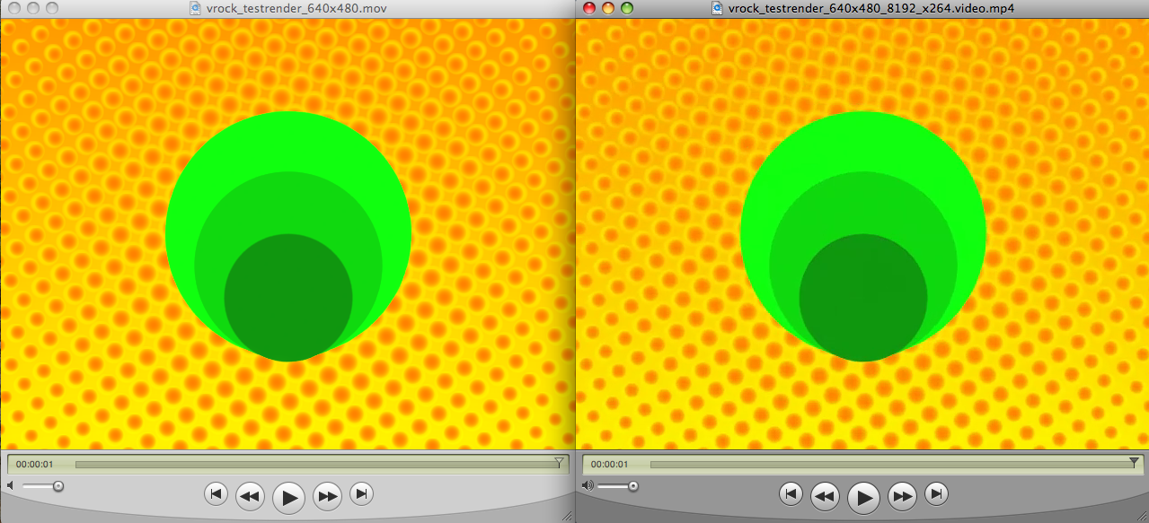

Thanks for having a look at this! Here the two attachments: a still image rendered in blender and then a 1 sec. x264 encoded sample where the first frame is the same as the attached still... (The still is also not quite perfect when you look closer at the round corners, I'm still working on that one, but it is nowhere near as bad as in the h.264 encoded sample.)Originally Posted by jagabo

OK, you have two issues. As mentioned before, the conversion from RGB to YV12 is causing bluring of the colors. Then your conversion from YV12 back to RGB us using a point resizing algorithm. This is causing the jagged edges.
(4x point resizing for clarity)
The left image is the original RGB source. The middle image is the source converted to YV12 then converted back to RGB, interpolating the U and V values. The right image is the source converted to YV12 then converted back to RGB replicating the U and V values.
When compressing with MPEG codecs an RGB source is usually converted to the YUV colorspace and then the chroma channels are reduced to half size (both dimensions). This is called 4:2:0 subsampling (4:1:1 ratio). So a 640x480 image has a 640x480 Y (luma or gray scale) plane, and 320x240 U and V (chroma or color) planes.
When you convert that YV12 image back to RGB the U and V planes have to be resized back up to the same size as the Y plane. As with any image resizing this can be done by a simple point resizing algorithm (duplication) or by a smoother, more sophisticated methods (interpolation, bilinear, bicubic, etc.).
If you are distributing this to others these YV12-->RGB conversions steps are not under you control. They will get whatever their players give them. For your personal playback you can look to see if your player has any control over the YV12 to RGB conversion.
Encoding with 4:4:4 subsampling rather than 4:1:1 would eliminate both these problems. But I'm not sure how widespread the support for 4:4:4 h.264 is. There is also the issue of which software is converting RGB to YV12 for compression. An RGB source might be converted to YV12 by the editor before being passed to the h.264 encoder. In this case 4:4:4 encoding would only eliminate the jagged edges. Or the editor may pass RGB to the h.264 encoder, in which case you will get the full benefit of 4:4:4 encoding (assming playback support for 4:4:4 h.264). I don't know the software you are using (I'm working under Windows) so I can't give you specific help on that.
As you've noticed, using different colors can make the artifacts less noticable. And using different intensities for the different objects may help a lot too.
