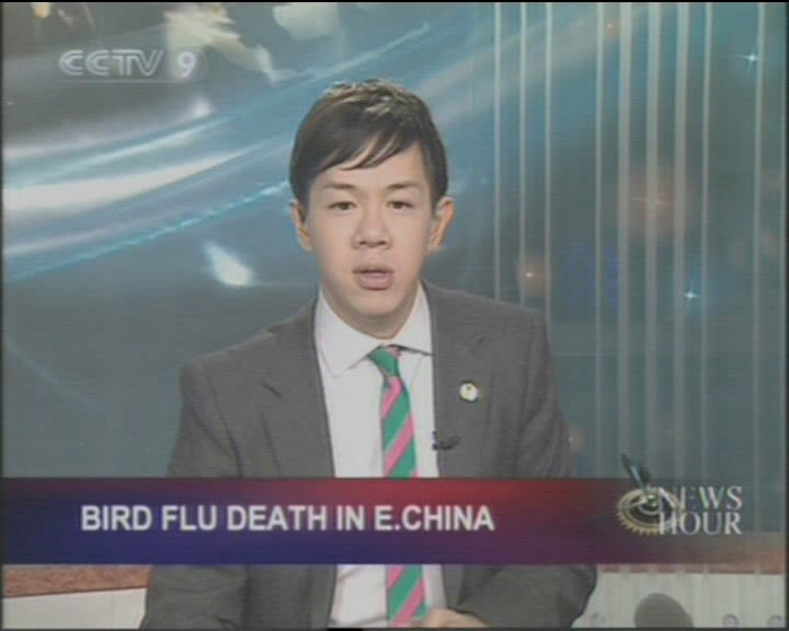

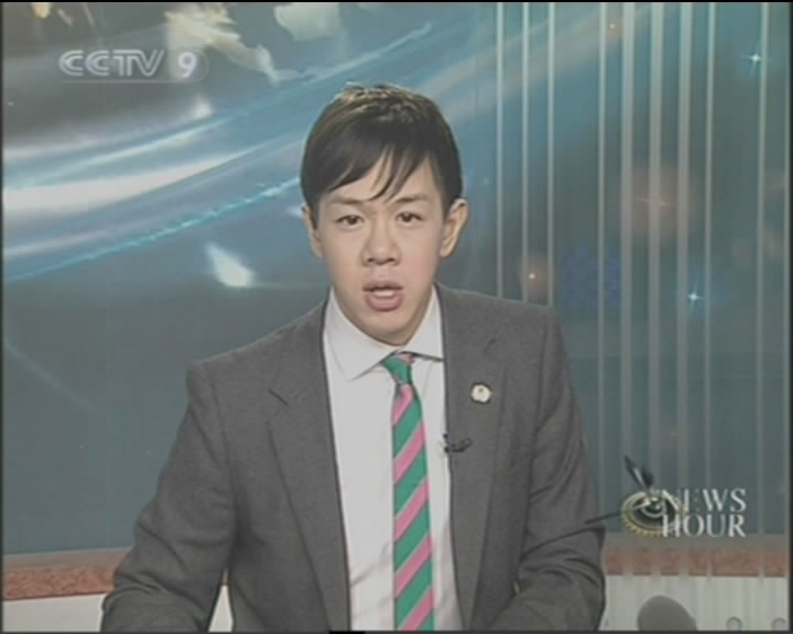

I have a cheap ($22) TV card and I found a way to get a better picture. I captured these 2 shots and made no adjustments between the shots. The first shot is made by putting the rf cable directly into the TV card in the computer. The second shot is made by first putting the rf cable into a TV, and then using the video/audio line out from the TV and connecting to the TV card. It is easy to see the the second picture is better (especially look at the cctv9 logo in upper left). By the way, the white balance problem (see white shirt) is a problem from from the cable company.

	I don't see any significant white balance problem. What you really need is to adjust the black and white levels.
