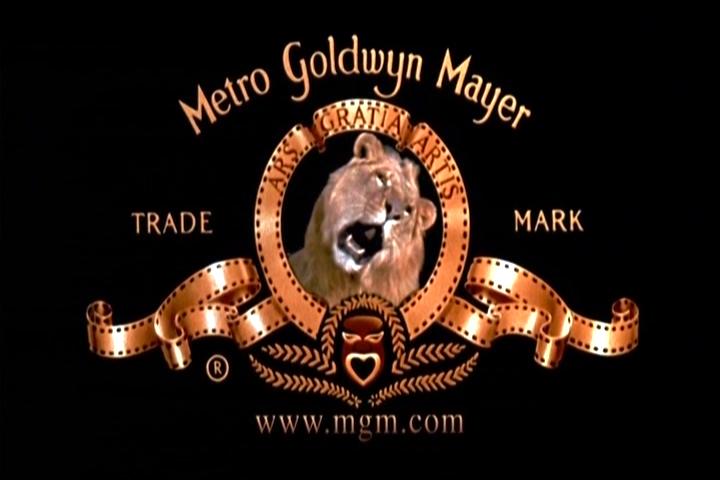

Heres a Capture from the start of the movie. It looks decent to me.

I noticed in your screen cap that you have have left and right sections cut off. So apparently by configuring in 4:3 you are going to have to sacrifice some parts of the viewable area.
I have my 211 to output 16:9 1080i. I have the recorder set at 16:9 TV and to display 4:3 as full screen. If I switch the 4:3 output to normal it outputs WS with black borders on all sides. So then if I zoom the 211 it fills up the entire screen (bo black), but also with some loss of viewable info. It looks that is what is happening to your screen cap also. I say that because the MGM lion has more black to his left and right, but is missing in your cap. I could be wrong, but feel pretty certain. Only way to verify is do a screen cap of a MGM movie you have from the store and compare. -
You could be right I've sort of wondered about that but it isn't enough to bother me. I suspect that the TV1 S-Video when TV1 is set to 16:9 is squashing it that way on purpose. I'll have to go back to the DVR and do a A to B comparison as soon as I remember where I put the DVD.
The way that DVD was authored it looks OK on a SD 4:3 and the 16:9 HDTV, since I have that mix in the house I'm ok with it. Since my main purpose in this recorder is for Capturing QAM from basic cable and it does a good job of that and has a better quality of video via the tuner than from the S-Video -
