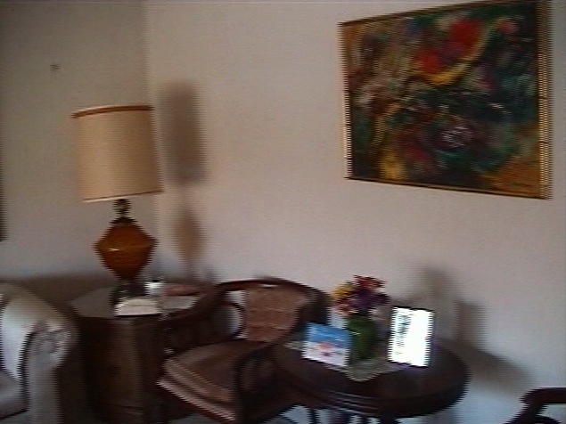

  10. Video Restorer lordsmurf's Avatar
    How does deinterlacing help sharpness? That makes no sense. You throw away half of the video detail when deinterlacing, so it gets softer, not sharper.
  11. Member terryj's Avatar
    N35°25.24068, W097°34.204
    Smurfy,
    it depends on the OP's definition of "sharpness/unsharpness",
    we are trying to determine what that is ( see post).
    If his/her definition is " jaggies", "wavies" or "teeth/stairsteps"
    causing the picture not to be sharp, then yes De-interlacing
    will help to make it "sharp" albeit not " sharp" in what your thinking,
    but "sharp" in removing this distortion, by using blending
    which will make the playback "soft" but will lessen the distortion.
    if that is what the OP means by "unsharpness",
    which we haven't determined yet.
    If the Op could post a screen shot of his/her playback
    of his /her video, we can figure it out...

    Nov 2007
    here's a pic
