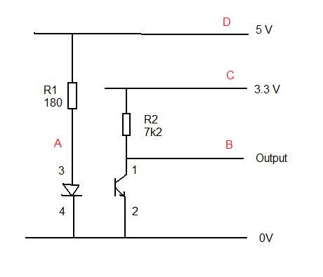

    Please look at the circuit that we have been using
    and your one- shouldn't the 3 and 4 on your one be the other way?

    According to the manufacturer’s spec sheets it is the way round I showed. Your measurements agree with this. The part between pins 3 and 4 is a light emitting diode (LED) and as a diode it only lets current flow one way, that is the direction of the arrow. On the part of the spec sheet you have shown above you can see the arrow points from pin 3 to pin 4. So for current to flow (and the LED to emit light) this means pin 3 must be more positive than pin 4. In my drawing I just turned it round because it is easier to follow, but I still have the arrow going from pin 3 to pin 4.
    In your circuit in your last post you have pin 3 to connected to 0 V and pin 4 to 5 V (via the 180 ohm resistor). This way round the LED will block current flow and will not emit light. This is exactly what you have measured, you have 5 V at pin 4 which shows there is no current flow. If you swap the connections round so that 4 goes to ground and 3 to the resistor you should be able to measure about 1.7 V. This figure is shown on the spec sheet as the forward voltage of the LED and is what would be expected when it is allowing current to flow.
    The half of the device between pins 1 and 2 is the phototransistor. This device acts like a switch, when it detects the light from the LED it turns the switch on and connects pin 1 to pin 2. When it doesn’t detect light it turns off and disconnects pins 1 and 2. Even when switched on it will only allow the current to flow in one direction, similar to the LED, the arrow shows the direction of current flow, which is why pin 1 connects to 3.3 V via the resistor and pin 2 connects to 0 V.
    At the moment the phototransistor is not detecting light so it is off and pin 1 will be at about 3.3 V. Again this ties up with what you have measured. When you change the LED connections round as above and measure about 1.7 V between pins 3 and 4 then you should see some changes between pin 1 and 2. With the LED connected with 3 and 4 swapped and there is 1.7 V between them, when there is nothing in front of the detector you will still measure 3.3 V. When you bring a piece of white paper close to it then the phototransistor should turn on and you should measure about 0.4 V between 1 and 2. This is listed on the spec sheet as the VCE Saturation Voltage.
    I don’t think you have blown the device at this stage, since the measurements you have made are what would be expected for how you have it wired. Unless at some point you shorted out one of the resistors there is no reason to think it should have burnt out. I think you are very close to getting it working.

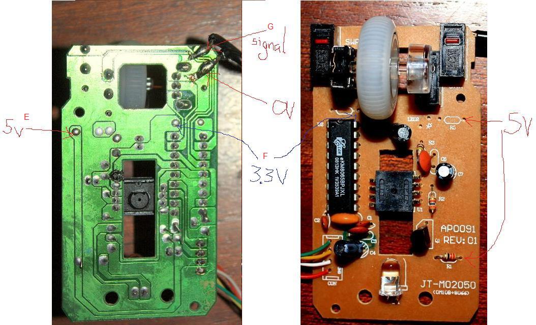

    I have done the following: I converted a mouse (acknowledge James Rueben):
    Used the following circuit (acknowledge James Rueben)::
    Connected to an IR receiver:

    It may be the resistor values I gave you need adjustment. To work this out, I need you to make some voltage measurements. I have labelled four points on the circuit A, B, C and D. The measurements need to be made between the zero volt line and each point in turn.
    First with the projector turned off and the shutter blades turned away from the IR receiver, measure the voltage at the four points. Now turn the blades so the white painted one is close to the IR receiver at the point where it triggers the mouse and repeat the measurements. What I hope to tell from this is how much current the LED part is drawing and how much current the phototransistor draws when it is turned on. To work out the current I will need to assume the resistor values are as in your marked up version of my circuit above with R1 equal to 180 ohms and R2 equal to 6k2 (6200).
    The graphs in the spec sheet for the IR receiver imply it is most sensitive at about 0.02" or about 0.5 mm, which ties up with what you are finding. But it should still operate fine at 0.1" or about 2.5 mm. If you can trigger it with just your hand this sounds good as human skin should not be as reflective as gloss white paint. The spec sheets also say it will trigger in microseconds which is at least 100 times faster than you need even at 18 fps. It may be you need a circuit similar to the one suggested by buckethead to clean up the pulses, but let's see how the voltage measurements come out first.

    Sorry Albie, I wasn't clear about the second set of measurements. I should have added this was also projector off and stationary blades with the white one next to the sensor. If your second set is with projector stationary, then the phototransistor is definitely not switching on enough. If the blades are moving it is not possible to tell.
    What I can tell so far is that the LED is working and drawing about 16 mA. R1 could be reduced in value to increase the current to a maximum value of 50 mA. This will make the LED brighter and therefore more likely to switch the transistor on, but it may also cause it to switch on when you don't want if it gets a bit of reflection from one of the matt black blades for instance. For the moment let's leave this where it is.
    The 5 V supply is lower than expected which could indicate a problem with volt drop on the cable (cable to long or too thin). However as the 3.3 V supply is good it doesn't indicate a generic problem here with the cable and this is the more important one for switching.
    If it was working as expected B should be around 0.4 V when the projector is off and the white blade is in front. Once you can either confirm this was your measuring condition or repeat the second set in this condition I should be able to suggest the next step.
    Just to be sure there are no problems with the cables and to save exchanging another set of messages with my one week delay added, can you also check the voltages where you have connected wires to your mouse as follows. Measure against the same zero volt point you used previously.
    Projector off, blades stationary and turned away from the IR receiver: measure the 5 V (point E), 3.3 V (point F) and signal (point G). This set should be at the same time as the first set.
    Projector off, blades stationary and white painted blade in front of the IR receiver: measure the 5 V (point E), 3.3 V (point F) and signal (point G). This set should be at the same time as the second set.
    These should be the same or very close in value to B, C and D, but will allow any cable problems to be eliminated.
    As a final check on the cables, measure between the zero volt point on the detector circuit and the zero volt point on the mouse. The projector state doesn't matter for this one. This should of course be zero or very close to it.

    Here are the results:
    With the IR detector facing away from the blade:
    A: 1.3V
    B: 3.4 V
    C: 3.4 V
    D: 4.25 V
    With the IR detector facing towards the stationary blade:
    A: 1.3V
    B: 1.55 mV
    C: 3.4 V
    D: 4.25 V
    E: 4.25
    F: 3.4
    G: 3.4
    E: 4.25V
    F: 3.4V
    G: 155mV
    0.02mV
    So it looks as my point E just produces 4.25V. Should I try a different spot, or is this OK? One can see there is a definite drop in the signal when the sensor is in front of the stationary blade. At least one can also see what happened when the blade was rotating (previous post)
    Thanks for your advice
    Regards
    Albie
    Mar 2009
    No problem with the 4.25 V since it is the same at D and E, so there is none dropped in the wiring. The only value that stands out is G at 155 mV, which might mean a volt drop on the wire between B and G. However even then it is still low enough to trigger the mouse input which only needs to be below 0.8 V (800 mV). May just need to resolder the connections at either end of this wire.
    I looked at the other forums and I think a lot of people have been confusing things. Without a doubt the best feedback you have is from Mr RB on http://www.electro-tech-online.com/electronic-projects-design-ideas-reviews/93594-trig...ect-paint.html. Try his suggestion of replacing R2 with 100 k, or even take it out altogether as there is an internal resistor of 170 k in the mouse.
    I would not recommend changing R1, the results you have measured show it is turning the transistor on. I also wouldn't recommend an opto-interrupter for all the same reasons given by Mr RB. As I said before you are really close to getting it working.
    Regards

    Taking R1 down to 68 ohms gives you a current of 43 mA which is getting very near the limit for the LED and you risk burning it out. Your first measurement with 100 k for R2 showed you were getting an output down to 0.07 mV which is more than adequate. I strongly recommend you put the 180 resistor back.
    Mr RB suggested fitting a trimpot, this may well be the solution because you can then adjust the value of R2. I would put the original 6k2 in series with this so if you wind the trimpot to zero it won't burnout the transistor.
    Before doing this I just want to check something. Did you fit a switch which I showed as SW2 in my posting back in my posting on page 4 of this topic dated 10 05 09? Have you tried with this switch (or the original left mouse button in the modified mouse if it's still there) to see if it will trigger Cinecap. I found the modified mouse goes to sleep after a while and needs to be unplugged from the USB and plugged back in again to wake it up.
    Regards
    JamesReuben
