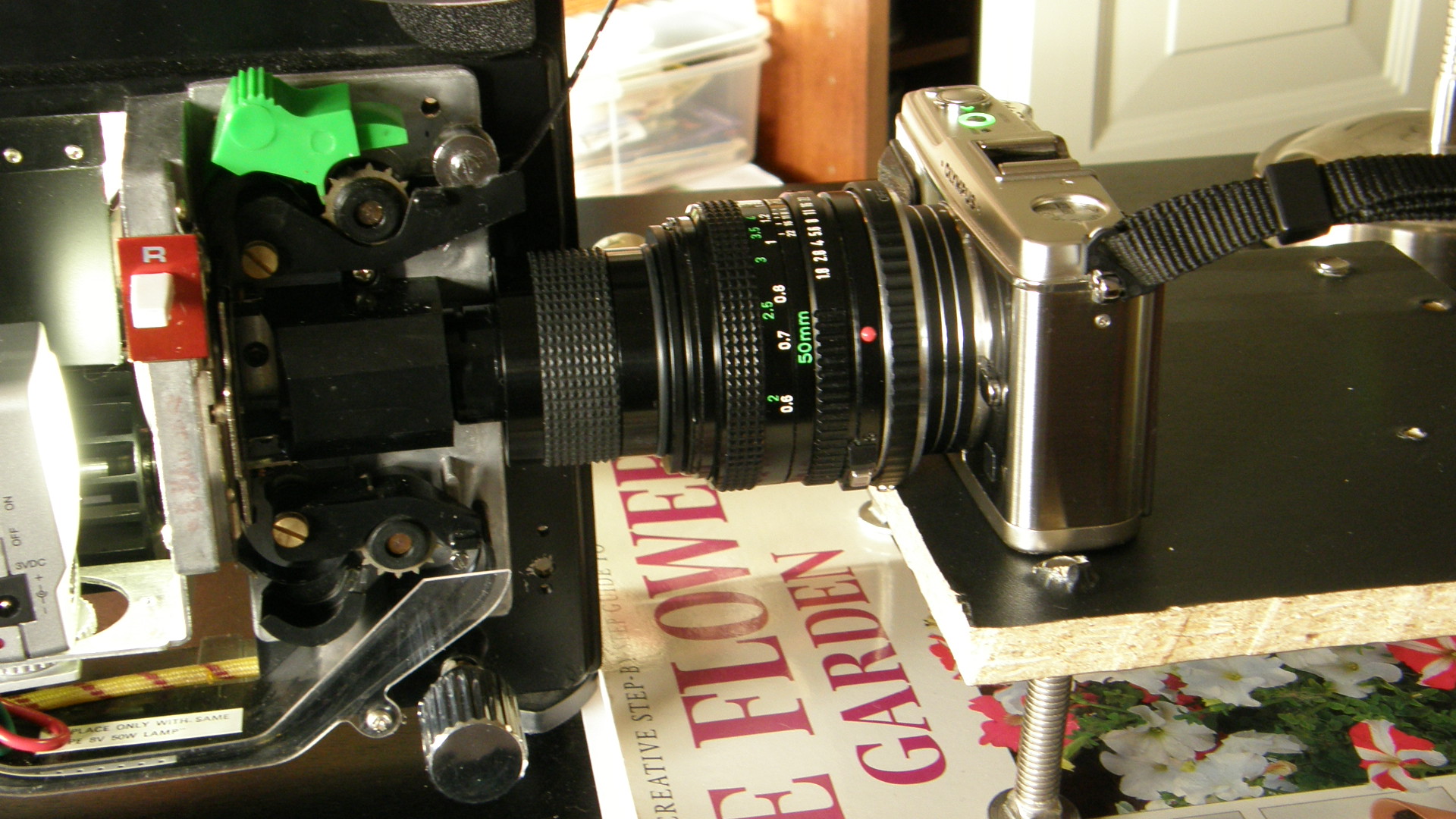

    Thanks, nice to get some positive feedback after working on the setup for 2-3 years now. No, I do not do any special post-processing except for duplicate frame elimination, which I do by using my own program (willing to share it). The camera does a pretty good job. I am using Olympus EP1 pen camera in HD video mode with manual focus and ISO set to 100. The apperture is set around 4 I believe but will double check. The lens used is a 100mm macro lens with 200mm extention tubing which gives 3X magnification. 3X is needed since the film is 7mm diameter and the camera sensor is 18mm. The led light I used is one of those video led lights, such as:
    http://cgi.ebay.com/Sima-Universal-LED-Video-Light-/230595257101?pt=LH_DefaultDomain_0...item35b08c630d
    I added a diffuser in front of it. This particular product gives a "warm" light so I keep the white balance at auto. The white led array I used before gave me "cold" images which did not like too much. Here is the picture of the setup.
    Regards,
    Stan

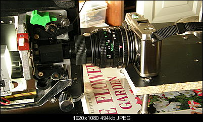

    PS. Here is my older setup for virtual image cpture

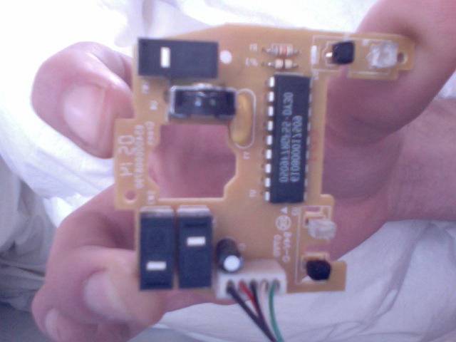

  21. Hi all,
    I'm a college student working on my senior thesis which I'll be shooting on Super 8. I've been building my own telecine machine over the past few weeks using an old Chinon 6100 projector. Not the best quality item but it seems to be working decently. I've managed to slow the motor (still the original built-in motor) down to 4 fps, I've removed the shutter, and replaced the bulb with a 3W 700mA LumiLED with a small piece of opal glass between it and the film gate. I've ordered a lens (a 5" double convex) and I'm planning on recording the floating frame from that using an HD Panasonic, capturing through capturemate and a mouse trigger.
    I'm having trouble designing my sync-mouse setup. I'm fairly new to circuitry and don't know exactly how to proceed. My plan is to use a TCST 1000 optical sensor which will run to the mouse, activating the switch and hitting capture in the computer (as discussed at length in much earlier posts). The sensor will be activated by a circular piece of PCB with a single notch cut out which will be attached to the rotator shaft which drives the pulldown. It should activate once with each new frame. I'd like to run the power to the sensor from the USB (which is rated at 5V on the mouse), as an earlier post suggested, but can't find any specs on the mouse I have (which is an old Dell rollerwheel). I'm terrified at the idea of frying my computer by bad connections (if that is indeed possible). Any advice on how to proceed?? I have to order most of my components offline as I don't have any shops other than radioshack around, and time is of the essence.
    Any help is greatly appreciated.
    Also,
    is there any way to use the optical sensors on the mouse? There are two (one for y axis and one for x axis movement). Seems like there might be a shortcut there.
Name:	Photo on 2011-04-10 at 16.24.jpg
