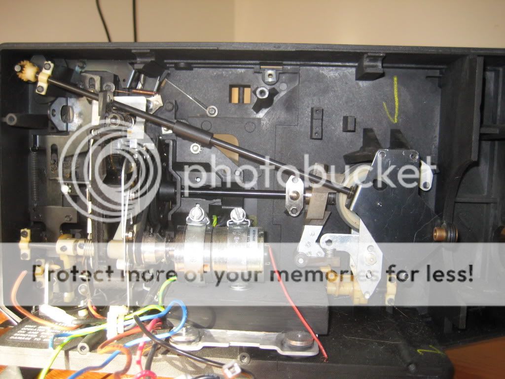

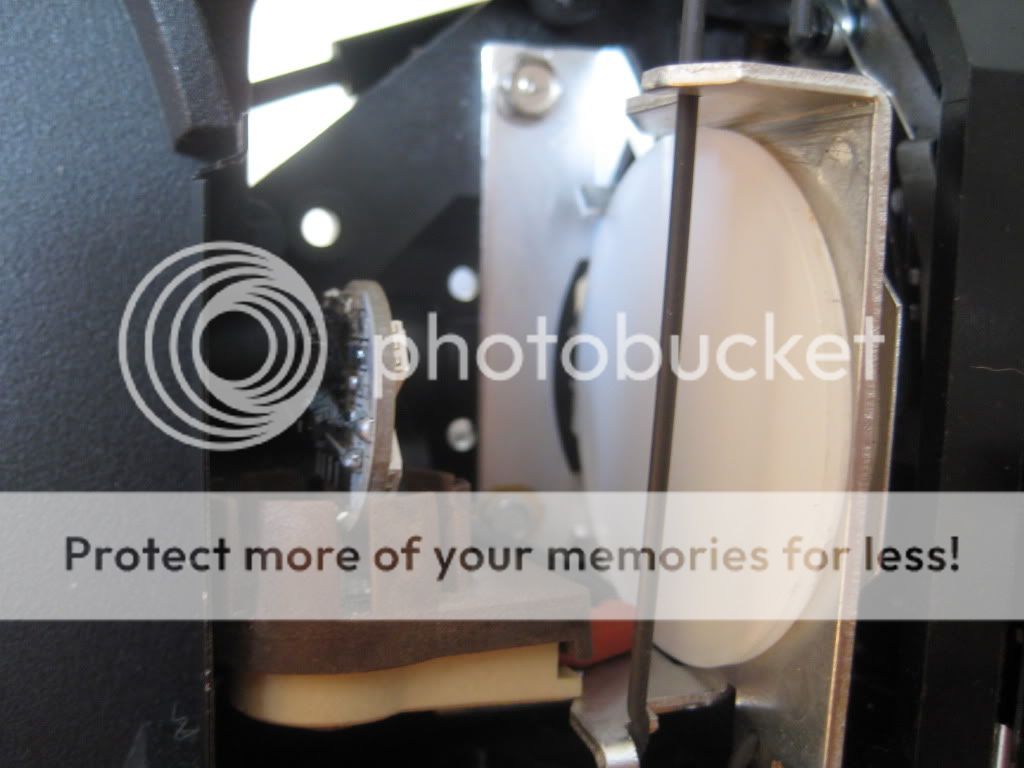

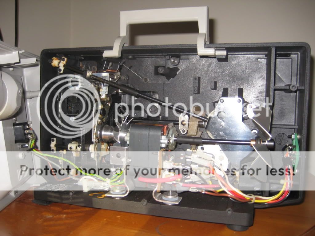

    Secondly the switch. I have put my Eumig in the loft. Mike you asked about the placement of the switch on the Bell & Howell, well the options are endless compared the 610D and I am 100% confident that anyone with a minimal mechanical and electronic experience would get this projector to trigger and tap dance, just look at the room inside! I had the micro switch triggering off from the one remaining blade. Then I thought of triggering from a home made cam on the shaft. Both ideas will work easily. Look at the picture, sorry about the rather crude drawings of a micro switch. The shaft is highlighted in blue and is directly linked the shutter. Then I thought about proximity switches, after all, no bouncing or mechanical failure. Then I find out about this Hall switch idea. For me, it’s not about where or if, but more of a case of the best kind of switch to use.
    Mar 2009
    Hi everyone. I have almost finnished my project. I have a working exanple. It's a bit slap hazard
    at the moment as there are a lot of things that need to be tidyed up. But it works And I loose
    no frames! Mike, I hope you can see the switch setup there. The red LED is for reference really,
    telling me that the micro switch is working fine (taken from the push to break side of the switch,
    Push to make is for the mouse) The mini double poll toggle switch (green LED) is to switch the
    mouse on and off via the av connection at the rear. I have updated the main LED light which is far
    brighter now which is good, as it is of course still cold I am looking into dimming it with a 1k pot
    for extra exposure control. On this particular projector I have not enlarged the gate yet, but
    that will be the finnishing off, I'm sorry for the very rough and crude look into the lense test but it's
    all there and ready to try when I have the time.
    http://www.youtube.com/watch?v=tx4IbmrSUyY
