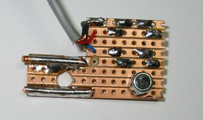

As I am bringing the 5 V from the USB into the projector I used a 4-pin min DIN connector as used by a mouse or keyboard. The plug goes on the detector board from the projector and the socket is on the mouse end. This is to prevent shorting the 5 V and damaging the USB driver in the PC.
I am sure there are better ways to mount, but mechanics is not my strong point. This photo shows the detector mounted on the post and then moved to be close to the white shutter blade.
While I adjusted the position of the strip board, it snapped by the hole I drilled for the tie wrap. I glued it back together and soldered some 2.5 mm copper wire from a mains cable along the tracks by the hole to give it some strength.
This made the board too high to fit back on the right of the post, so I reinstalled it on the left and it is now at about a 30 degree angle to the blade. You can actually get it in here without having to dismantle the gears. The photo below is trying to show this, but I just couldn’t get it to focus on the right point.

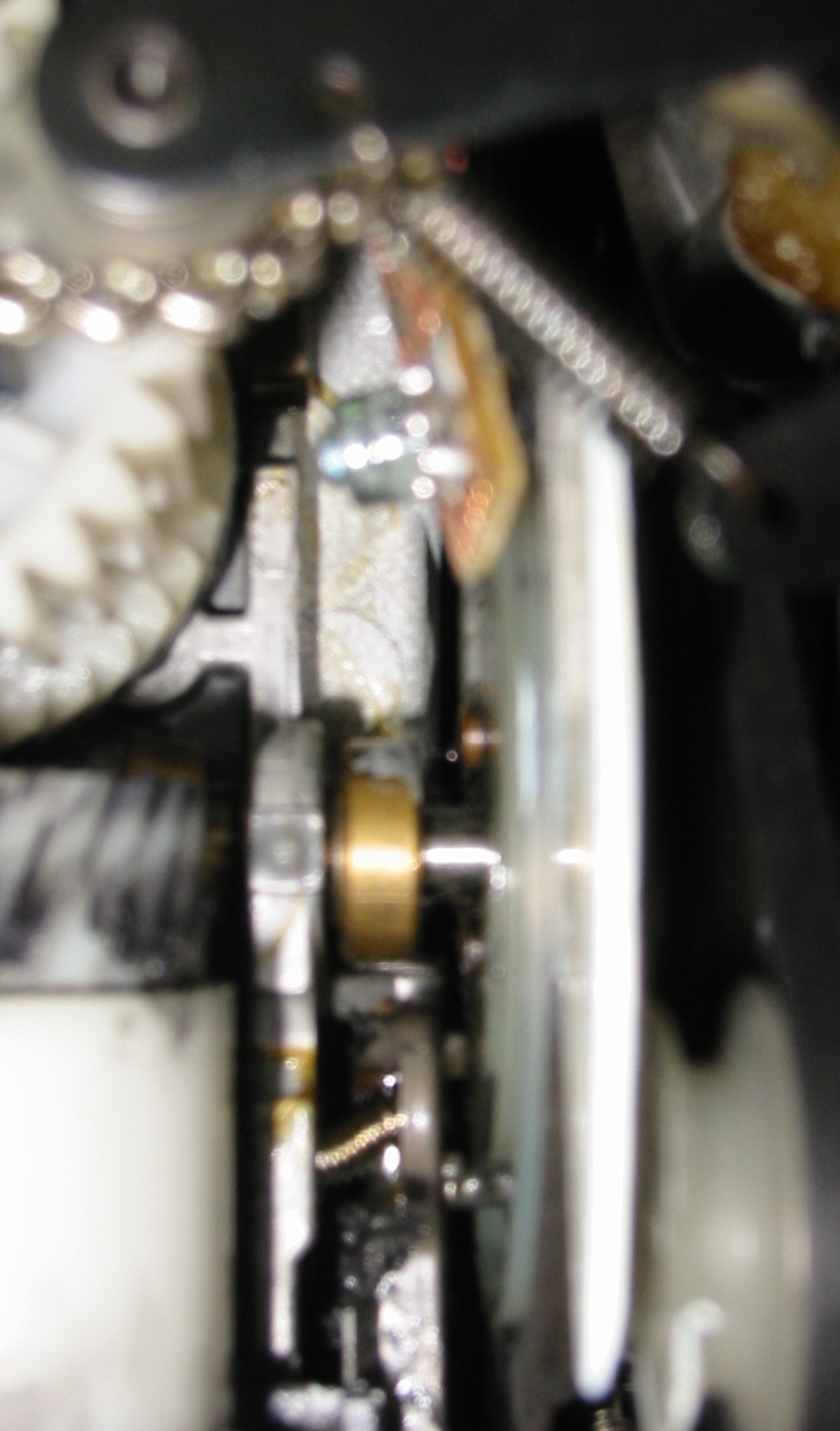

Further to my last post, I was playing around with the idea if one cannot mount the microswitch at the rear spindle wheel.
This pin with some modification, might trigger a microswitch, but it might cause a problem when one rewinds a film. The round wheel, closest to the camera feels as if it is moving at a constant speed.
Looking at the front, that wheel is moving at different speeds. I was thinking, if one could put a wider wheel between the wheel and the body of the camera, might that not work? But then I suppose, the new "wheel" will need to have several notches in the circumference???

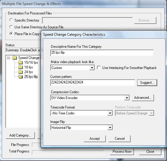

I am puzzled that the conversion you did with the standard 15/16 fps category looks ok, all this does is interlace the frames with no speed change. As you say the unconverted film looks like it’s in fast forward it would indicate you need to change speed. By default the cine should be 18 fps and if you play it back without conversion it will run it at 25 fps so it will look a bit fast.
The following is based on Wikipedia stating that South Africa uses PAL at 25 fps. If this is not the case you will need to adjust accordingly.
The cine you are capturing is at 18 fps (standard cine 8 mm speed) and you need to change to 25 fps. To do this in CineCap, go to the Multiple File Speed Change dialog and click on the Add Category button. Enter a name in the Descriptive name box, then click on the arrow for Make video playback look like. In the drop down list that appears select Custom. Now click the Suggest button next to the Custom Pattern and in the dialog box that opens set film speed to 18 and Video Speed to 25 fps (PAL), then click ok.
Now click on Compression Codec and select DV video Encoder. You can now click on the Image Flip drop down and select Horizontal Flip. Finally you can click on “Use Interlacing for Smoother Playback”, I don’t have this set but I haven’t played with it to see if it’s better. You could always set up two different speed change categories, one with and one without interlacing so you could compare results.
When you have done all this the dialog box will look like this and you can press on Add. Now drag your files to be converted to the new 25 fps category you have created.

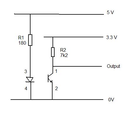

I've been looking further at the Optek OPB608A. You can get a more up to date spec sheet for it here http://www.optekinc.com/datasheets/OPB608.PDF. As you found earlier the input from your mouse switch is normally at 3.3 V, the spec sheet for your mouse controller confirms this http://www.emc.com.tw/twn/database/Data_Sheet/PC/eKM8065.pdf. Because of this I think it is safer if the transistor part of the detector uses 3.3 V, while the LED part carries on with 5 V. Again there is an empty hole on your mouse where you can pick up the 3.3 V.
Because of the change of device and the 3.3 V you also need to change the resistor values. I have annotated a modified circuit for you. R1 is now 180 ohms and R2 is 7k2 (7200 ohms). Be careful with the pinout of the OPB608A, pins 2 and 4 that you need to connect together are diagonally opposite.

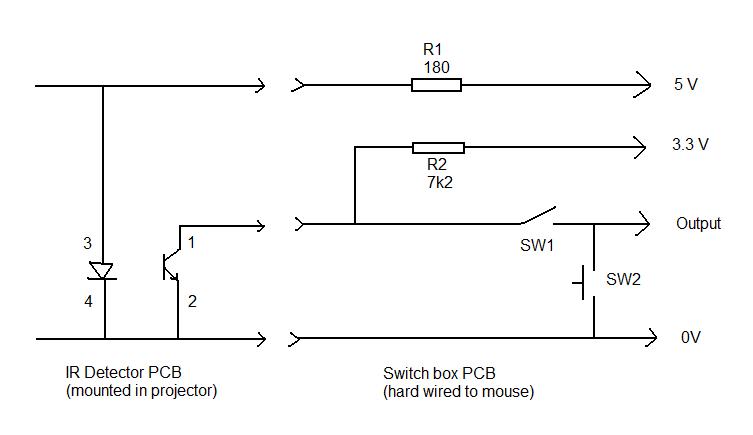

You asked previously about the small box in my photos with the switches on. This contains the switches and both resistors, while the L shaped pcb only holds the IR detector. This was to allow me to make changes to the resistor values without having to unmount the IR detector every time. The following shows how to achieve this.
Use a plug and socket to connect the IR detector pcb to the switch box pcb, 4-pin mini DIN is ideal. Make sure the plug connects to the IR detector and the socket to the switch box, this is to make sure the voltages don't get accidentally shorted out. SW1 is a single pole, single throw switch which is essential to isolate the IR detector. With the microswitch design you tried before, once the film stops so do the sync pulses because there is no tension on the film. With the IR detector the sync pulses are generated from the shutter gate which keeps going after the end of the film as long as the projector is playing, so you need to be able to stop this quickly. SW2 is a push to make, non latching pushbutton. It is used for testing purposes to be able to generate a few mouse clicks when needed.
Be careful when soldering to your mouse, the two connections you have already made look quite large and you need to be sure you don't short any tracks together.
When you have built the detector circuit try it out on the table by moving a piece of white paper onto and away from the detector to check it triggers a mouse click. Once you are sure it is working, then try mounting in the projector. It is a lot easier to find faults with the detector circuit before you install into the projector.Regards
