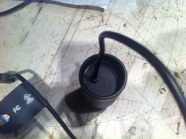

  6. I just finished Lifecam Studio modification. Removed stand, usb cable rerouted to the back of camera, removed lens with autofocus block, blue led painted with black enamel paint, removed microfon and call button. I installed back a front glass in order to protect ccd chip from dust.

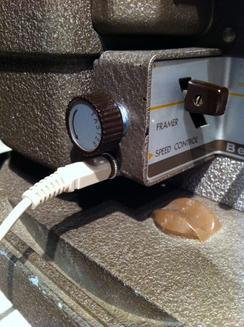

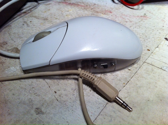

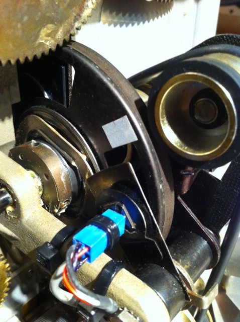

  9. Installation of optocoupler and mouse conversion done. Thanks to James Ruben's schematic mouse conversion was easy. I installed switch and resistors inside mouse. Optocoupler connects to mouse using stereo jack. It works like charm with CineCap software.
  10. Looking really good Alex...
    What model projector are you using...? From the 'Be' just visible in the pic - I'm guessing Bell & Howell, and it looks like it's already got variable speed.
    You're clearly progressing with this a lot quicker than I did...
    Cheers
    Dave
  11. Hi Dave,
    It is Bell & Howell model 253R. The original speed adjustment is mechanical and works like break pad. Unfortunately it won't allow me to reduce to low speed. I removed original mechanism and installed variable resistor that connects to DC motor speed controller. AC motor will be replaced with DC gear motor. I'm planing to use direct drive with timing belt.
    Regards,
    Alex.

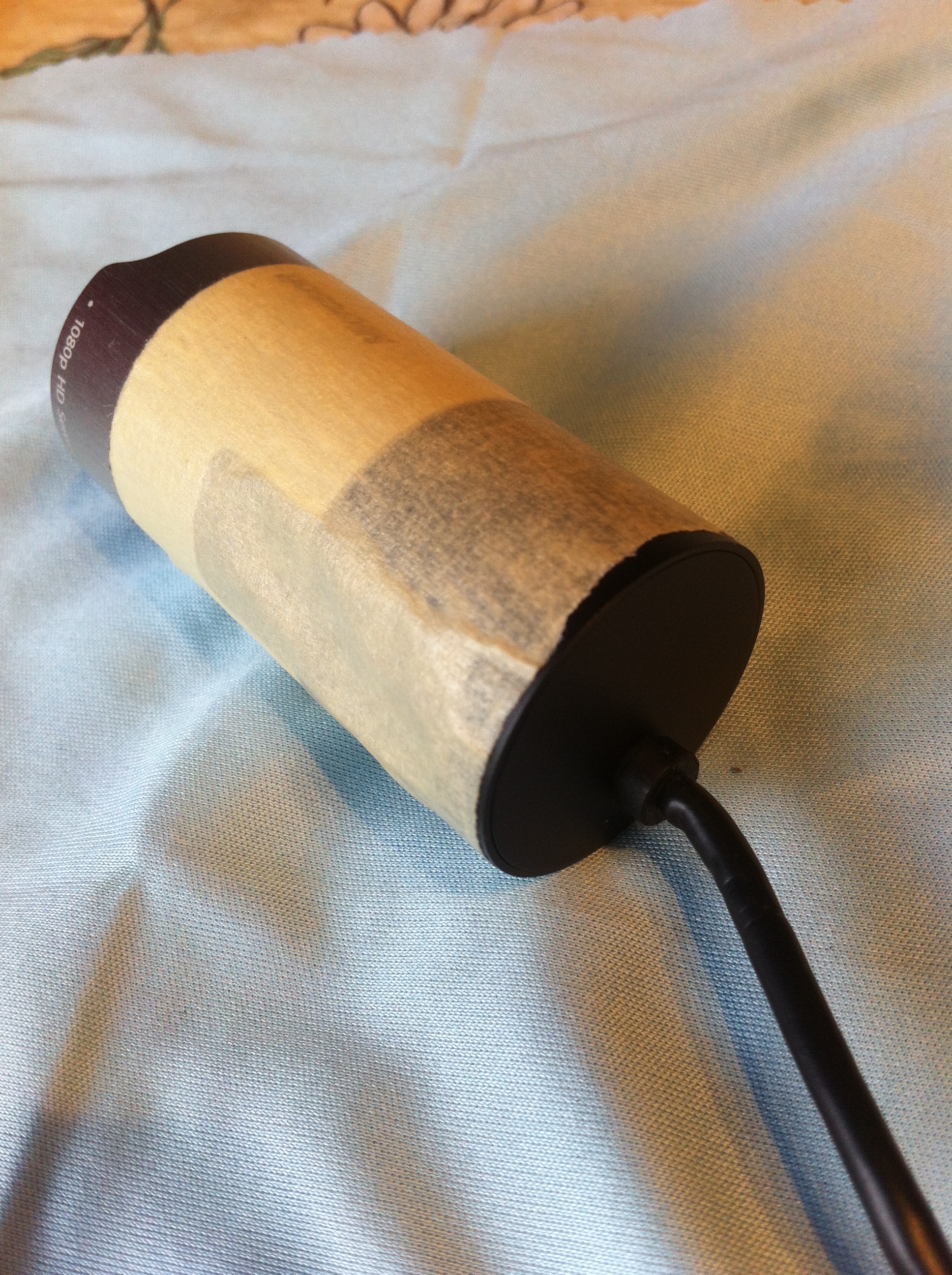

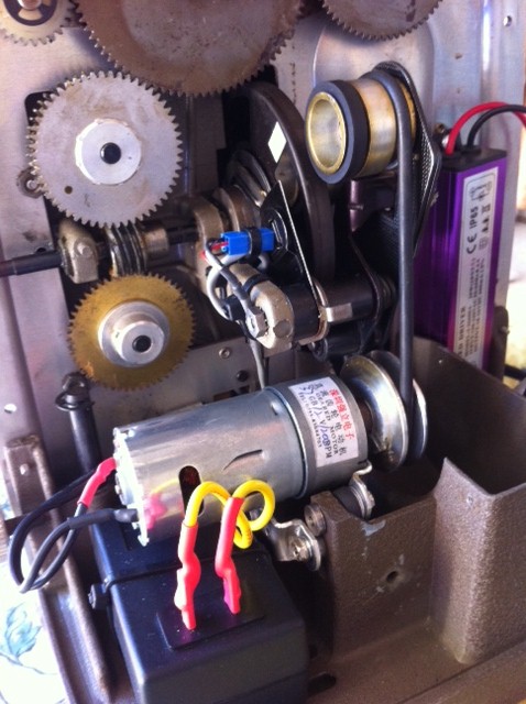

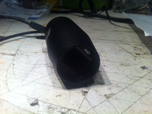

  12. Work progress: DC motor installed in place of old AC motor. Enclosure for LifeCam Studio is made out of rifle scope eyepiece.

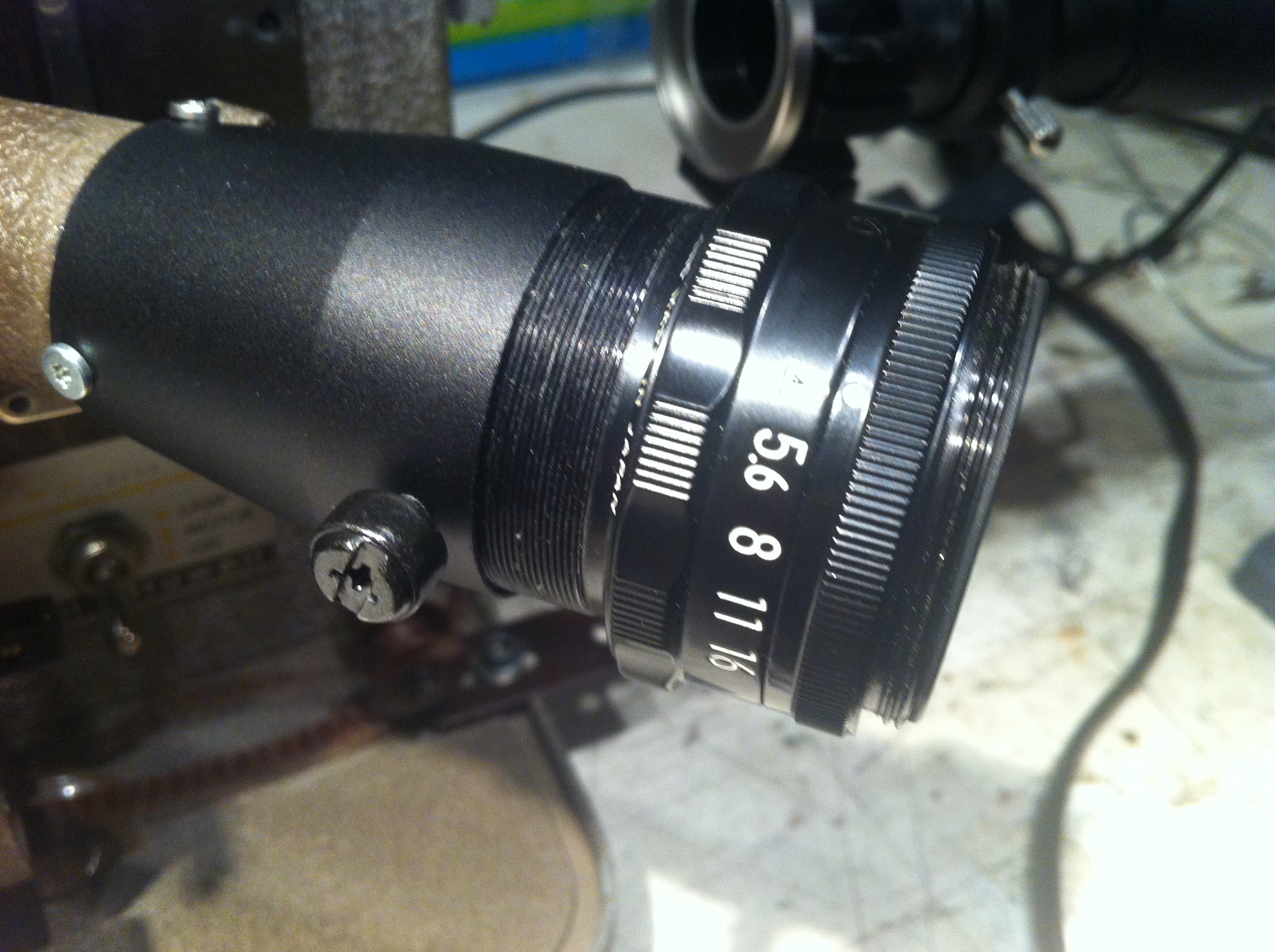

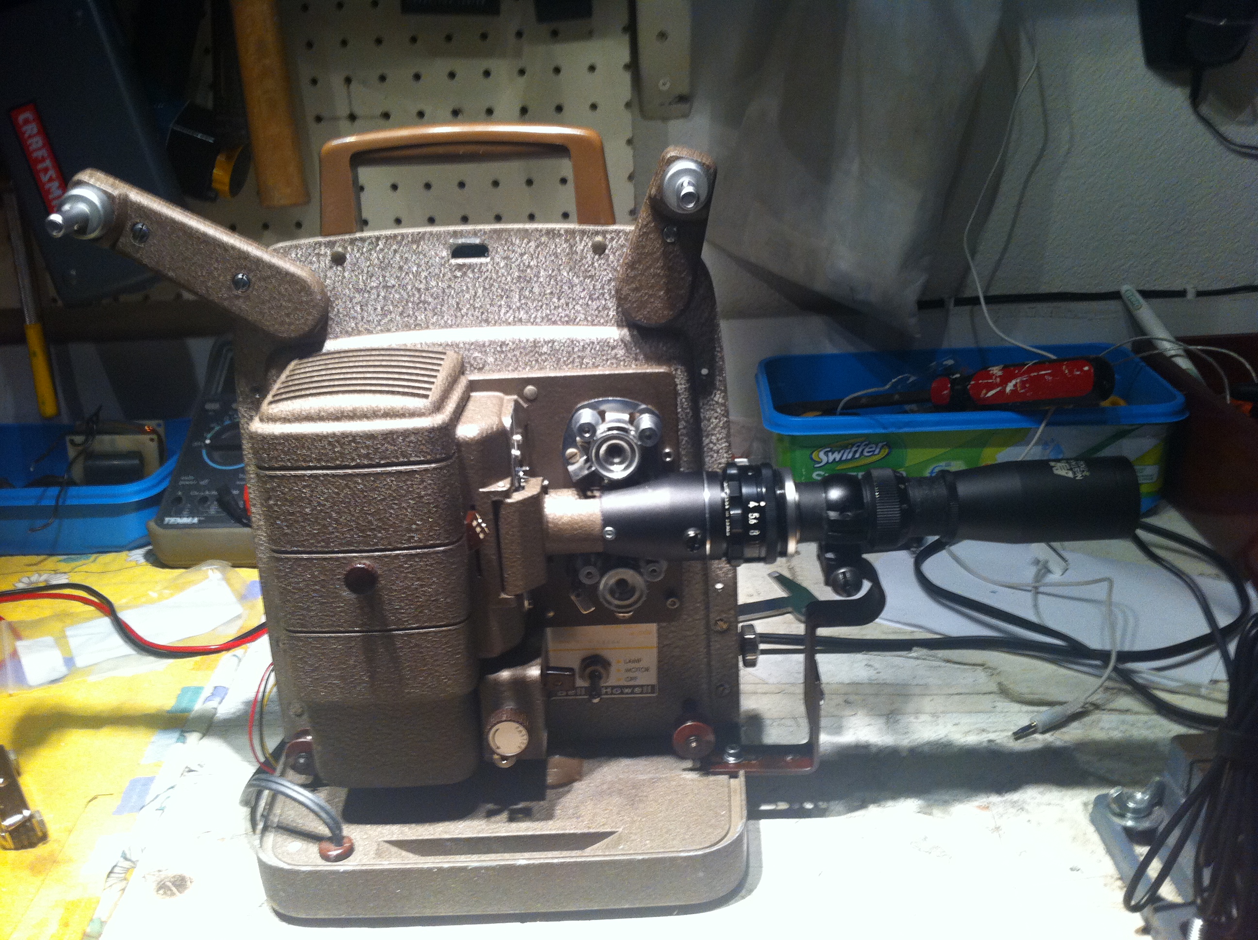

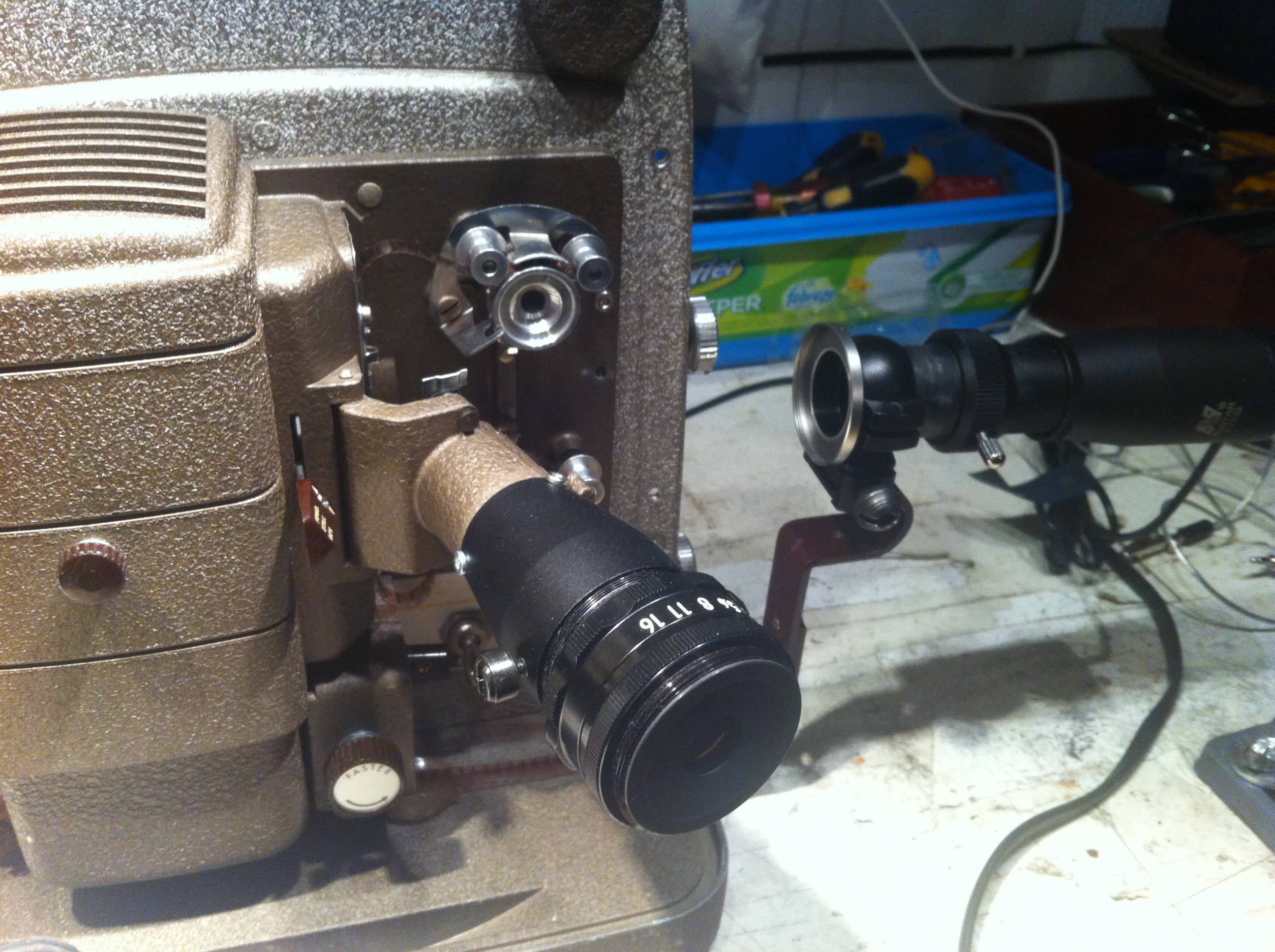

  13. Just managed to attach lens & camera to the projector:
Name:	Photo Dec 14, 20 57 49.jpg
Name:	Photo Dec 14, 20 58 05.jpg

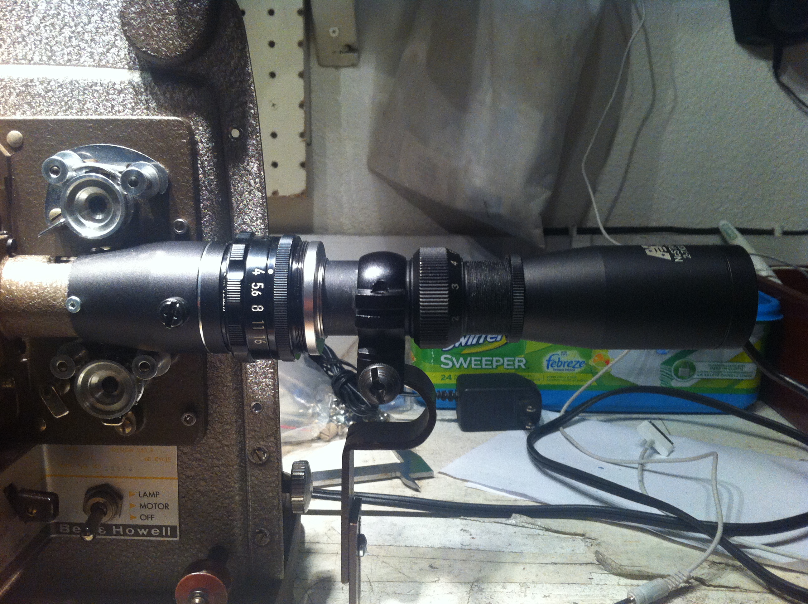

    Leshka, hi
    I am impressed with the looks of your lens and webcam. (actually your whole setup looks cool)
    I have a few questions which I am curious about:
    1-What is the "dial" with numbers 1,2,3 etc just before your camera?
    2-Your enlarger lens looks like it is fixed into position. Did you first find the ideal focal distance and then fix it? Is the focus adjustable at all/how do you focus?
    3- We are all waiting to see what your captured frames look like
    regards
    Clive

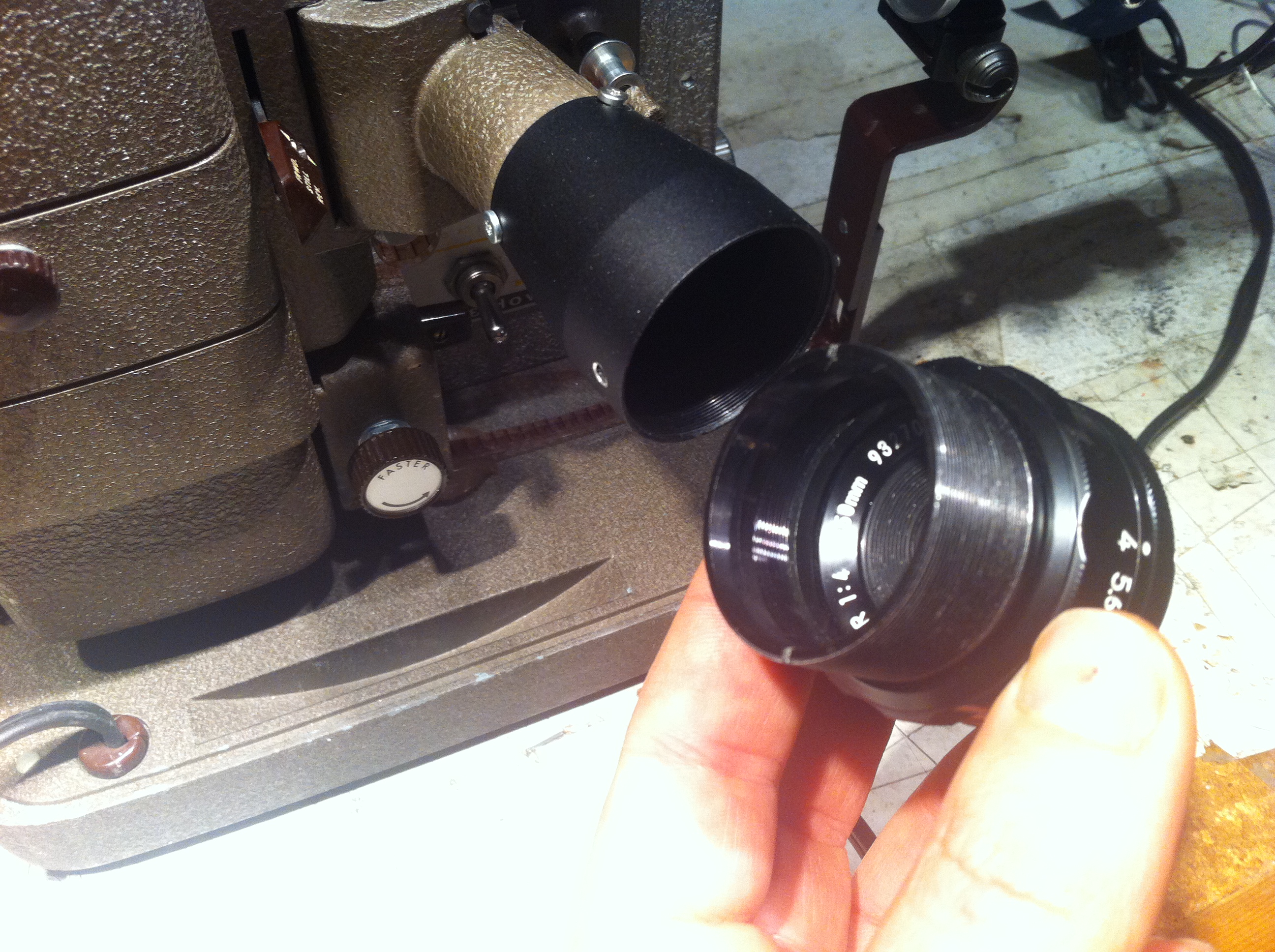

  15. Hi Clive,
    Thank you for your compliments. Here are answers

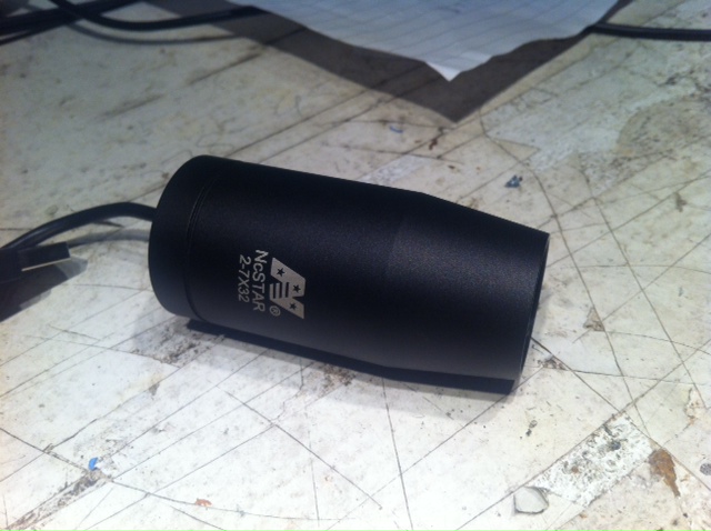

    1. The dial with numbers is just a part of the rifle scope that i "vandalized" for lens setup. It just covers the hole in the tube.
    2. Lens is not really fixed. It screws in. This how I can adjust focus. Here are some pictures:
Name:	Photo Dec 19, 18 07 53.jpg
Name:	Photo Dec 19, 18 08 43.jpg
Name:	Photo Dec 19, 18 09 39.jpg

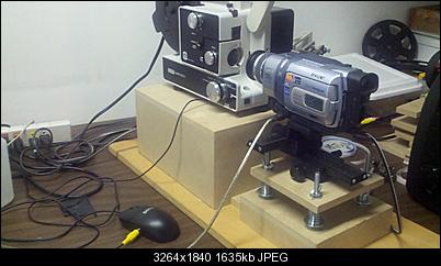

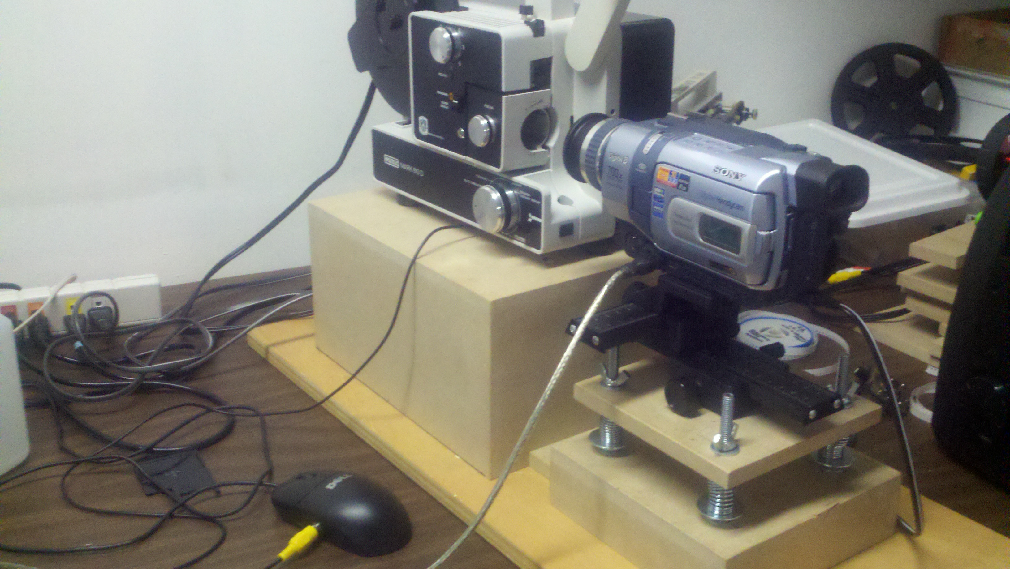

    Sep 2009
    Hello Alex,
    Thanks for checking the video out. The film was my Dad's, kept in a cardboard box for the past 50 or so years. No special care was taken so I feel fortunate that the film was in fair condition. The film was dirty so I use Film Guard to clean it. I have had good results with it.
    I made my machine using the guide that has been found on the internet using the Eumig 610d projector. I don't use the Condenser Lens. I put a Raynox 250 Macro lens on my camcorder (sony tvr-340) and capture from the gate at 3 fps. I did use Avisynth post capture. I still have a lot to learn and lot of film to transfer. I would like to get a better camera and lens because I don't think I'm getting the best image possible. But the results are passable. My family is very pleased. Will keep you posted as things progress.
    Mike (wadiigo)
Name:	Camera Setup.jpg
