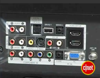

I'm glad this thread already exists as I'm having some related issues connecting my PC to my Samsung LN3251D.
My Sammy has 1 VGA and 2 HDMI inputs.
Graphics Card: NVIDIA 6400GT PCI-E (card has 2 DVI outputs)
I purchased a Monster DVI-HDMI cable ($70) at Best Buy. Upon hooking it up to my LCD, the screen is always "searching for signal". I've tried various resolution settings, and cannot seem to get a picture on my Sammy.
I can however run DVI-VGA and I get a picture. However, the color is off somewhat and everything seems to have a red tint (I believe there's a short in my DVI-VGA cable and this is the reason for the off color. The color will correct itself when I put pressure on the cable where it connects to my graphics card).
I've since ordered a different DVI-VGA cable in hopes it will get rid of the color issues.
I would prefer to run DVI-HDMI - if anyone has any suggestions that would be great. I do not have a 2nd graphics card to test so I'm not sure which component is causing the issues.

First suggestion is return that $70 Monster cable to Best Buy.
DVI-I connectors (6400GT and others) contain pins for DVI-D and VGA (RAMDAC). Most cards come with an adapter to tap the VGA pins to a standard VGA DB-15 connector allowing a standard VGA cable to be used. There is no reason to pay the high retail prices for a "DVI to VGA" cable either. -

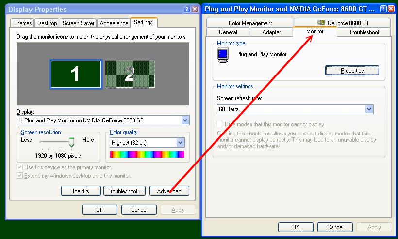

Did you also change the refresh rate to 60 Hz? Most TV's require that.Originally Posted by anthojoe
Yeah I tried it on several different refresh rates..... no dice.
