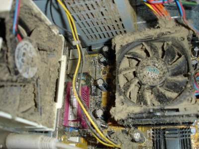

    If it looks like this when you pull off the side covers, you definitely need to do some work.
    Crickey! Thats one dusty PC. Is that saveable or is this one going to PC heaven?

    That pic is a extreme case. It shut down after a short time from start up. You can blow out most dust with some 'canned air' from most electronics or hardware stores. But do it outdoors and use a dust mask. You don't want to breathe that stuff.
    A small paint brush, maybe 1/2 inch wide helps to free up the crud. You also want to hold the fans from moving when you blow out the fins. I use a plastic zip tie for that, shoved in there. That keeps the fan from running backwards or overspeeding. That can damage them. Be gentle with the fan blade surfaces also or you can damage the bearings.
