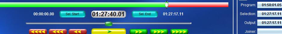

I guess this is something simple I'm missing but when I open a .TS file with VideoRedo I set the start/end time of the movie because I want to trim a portion of the end.
When I have the selection made I click on File/Save Video As...
When prompted I choose my output to also be .TS (also tried MPEG) but the resulting output file is just a fraction of the selection, just a few frames I guess.
My source movie is close to 2GB and the resulting file from VideoRedo is only about 140MB.
What did I miss? 8)
BTW - I'm using the trial version of VideoRedo.

This is exactly what I do but the resulting movie is just a fraction, even though the "Output" field on the bottom right hand corner reads that the selection is 01:27 (an hour and 27 minutes). See picture below..Originally Posted by jman98
