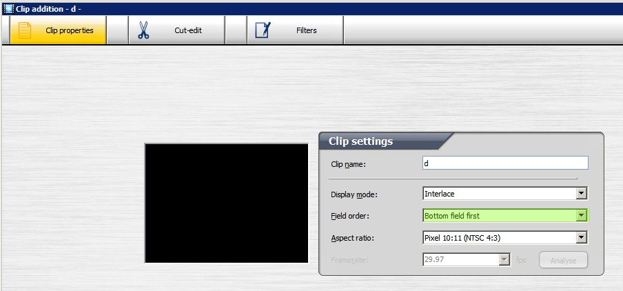

    To Deinterlace and Encode Progressive:
    Using TmpgencXpress: (The Green Highlights are Important)
    1) Load file, ensure it shows it recognized the file as having BFF
    2) Deinterlace with the following settings
    3) Ensure Mpeg2 encoding is Progressive
