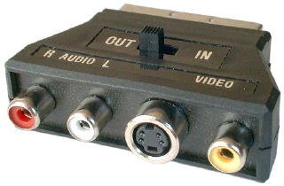

    well, the projector takes s-video, no doubt about this. However, my dvd player only has a SCART out, so I had to use an adapter SCART to s-video (the adapter also has red, white and yellow RCA).
    I tried the s-video cable from my laptop to the projector and it works fine. Do you think it's the adapter causing the black and white image?

    I would suspect the adapter.

    Those adapters will only work with S-Video if the SCART connector can be setup to output a S-Video signal.
    Check your manual/menu settings of the DVD player if this is possible.
    Lot of recent cheaper (european) DVDplayers don't offer S-Video output anymore, only RGB/composite.

    As for the simple adapter, here is the one I have. Do you think it could be a shitty one?

  14. I'd try a simpler SCART adapter like the one I mentioned on the other thread:

    The SCART adapter you showed should work with S-Video.
    But You need to set up the DVD player SCART manually from the setup menu to output S-Video.
    You can't have S-Video and Composite output at them same time from a SCART socket.
    If you using a composite connection when switching to S-Video it should switch to Black/White.

    Thanks The Doman, when I saw your post I thought that was gonna be it. But somewhow life is never that simple. Philips says the SCART can handle S-video, but the menu only has the possibility to set up the HDMI connexion......
    I guess I'm f***ed, is the only solution to buy a new DVD player?

    Yeah it looks like it!
    I checked the PDF manual of that thing and there it does not mention S-Video (or even configuring the SCART) at all?!
    http://www.p4c.philips.com/files/h/hts3115_05/hts3115_05_dfu_eng.pdf
    Some false advertising by Philips it seems to me?
    If your projector has the option for RGB (PAL/NTSC) input then there could be a possibility to connect it that way assuming ofcourse that Philips outputs a RGB signal over the SCART connector.
    But getting a cheap DVDplayer with S-Video out option will be cheaper I guess.
