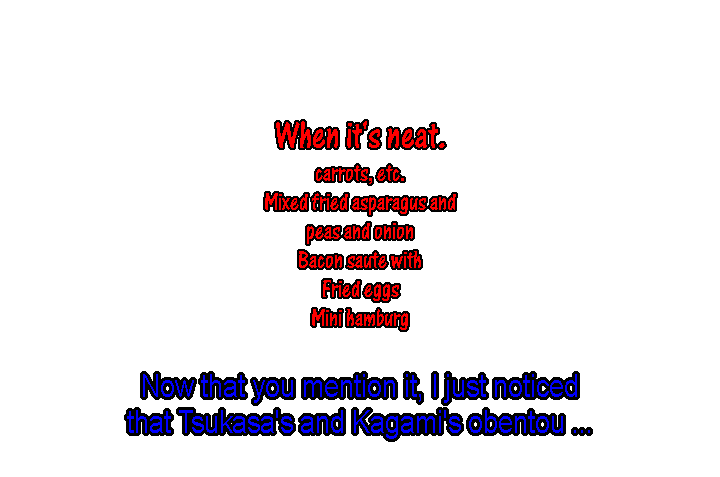

I find that maestrosbt doesn't read the pos tag in ssa and create a different picture of what it is supposed
the words also get reversed order which supposed to be translation for writtings-in-video.

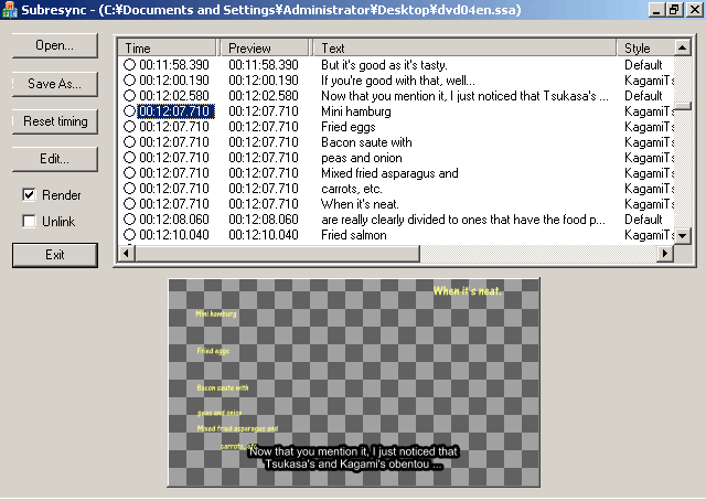

but then it recongnized it own manual positioning tag if position inside the gui [edit]

vobsub preview window which is correct pos
maestro output or preview window which is messup
after my manual estimated position in SBT refer according to vobsub resync window
and save as ssa from masestrosbt it gives this
edited: i find that the difference is only timing & extra line ontop of the need-to-pos-lineCode:Dialogue: Marked=0,0:12:02.58,0:12:08.02,Default,,0000,0000,0000,,Now that you mention it, I just noticed that Tsukasa's and Kagami's obentou ... Comment: Marked=0,0:12:07.71,0:12:08.21,*Default,,0000,0000,0000,,MSBTUSER: POSX=95;SNAPX=1;POSY=77;SNAPY=1 Dialogue: Marked=0,0:12:07.71,0:12:10.03,KagamiTsukasa,,0000,0000,0000,,{\c&H80FFFF&\bord0\fs20\pos(90,76)}Mini hamburg Comment: Marked=0,0:12:07.71,0:12:08.21,*Default,,0000,0000,0000,,MSBTUSER: POSX=84;SNAPX=1;POSY=161;SNAPY=1 Dialogue: Marked=0,0:12:07.71,0:12:10.03,KagamiTsukasa,,0000,0000,0000,,{\c&H80FFFF&\bord0\fs20\pos(85,147)}Fried eggs Comment: Marked=0,0:12:07.71,0:12:08.21,*Default,,0000,0000,0000,,MSBTUSER: POSX=108;SNAPX=1;POSY=247;SNAPY=1 Dialogue: Marked=0,0:12:07.71,0:12:10.03,KagamiTsukasa,,0000,0000,0000,,{\c&H80FFFF&\bord0\fs20\pos(103,218)}Bacon saute with Comment: Marked=0,0:12:07.71,0:12:08.21,*Default,,0000,0000,0000,,MSBTUSER: POSX=99;SNAPX=1;POSY=318;SNAPY=1 Dialogue: Marked=0,0:12:07.71,0:12:10.03,KagamiTsukasa,,0000,0000,0000,,{\c&H80FFFF&\bord0\fs20\pos(98,266)}peas and onion Comment: Marked=0,0:12:07.71,0:12:08.21,*Default,,0000,0000,0000,,MSBTUSER: POSX=140;SNAPX=1;POSY=345;SNAPY=1 Dialogue: Marked=0,0:12:07.71,0:12:10.03,KagamiTsukasa,,0000,0000,0000,,{\c&H80FFFF&\bord0\fs20\pos(131,296)}Mixed fried asparagus and Comment: Marked=0,0:12:07.71,0:12:08.21,*Default,,0000,0000,0000,,MSBTUSER: POSX=268;SNAPX=1;POSY=402;SNAPY=1 Dialogue: Marked=0,0:12:07.71,0:12:10.03,KagamiTsukasa,,0000,0000,0000,,{\c&H80FFFF&\bord0\fs20\pos(136,330)}carrots, etc. Comment: Marked=0,0:12:07.71,0:12:08.21,*Default,,0000,0000,0000,,MSBTUSER: POSX=585;SNAPX=1;POSY=53;SNAPY=1 Dialogue: Marked=0,0:12:07.71,0:12:10.03,KagamiTsukasa,,0000,0000,0000,,{\c&H80FFFF&\bord0\fs30\pos(570,37)}When it's neat.
Comment: Marked=0,0:12:07.71,0:12:08.21,*Default,,0000,0000,0000,,MSBTUSER: POSX=90;SNAPX=1;POSY=76;SNAPY=1
Dialogue: Marked=0,0:12:07.71,0:12:10.03,KagamiTsukasa,,0000,0000,0000,,{\c&H80FFFF&\bord0 \fs20\pos(90,76)}Mini hamburg

The function "\pos" is just a special case
of the function "\move", and neither VSFilter nor Maestro SBT
appear to support the "SFX side" of the SSA specification.
MaestroSBT now supports the \pos ASS tag, and reads ASS files as of version 2.6.2.0. However, manual positioning was possible since 2.1 using the preview window.
