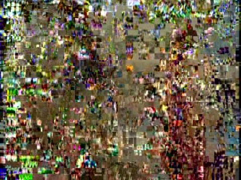

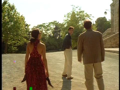

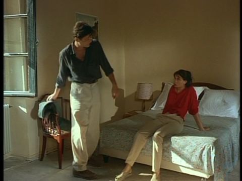

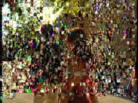

I was using HCEncGUI to encode a film using an AviSynth script that I'd used before to repal a PAL-NTSC converted disc and then slow down the resulting progressive 24.975 to 23.976. I've had success with this before on a 100 minute film. This particular project at NTSC speed ran 130 minutes. On the first pass (which took nearly 4 hours) everything seemed okay but as the second pass started, it looked okay but then began to break up into a heavily pixellated mess. I stopped the encoding and took some screencaps with PowerDVD. After the point where I stopped, it looks okay (I'm guessing thats from the previous encode).
Does HCEncGUI have a problem encoding 2+ hour films (at single layer bitrate - the original m2v was also below 4 GB) or is it the speed of my computer (the 100 minute project and another 90 minute film I used this .avs script with took about five hours total for 2 pass encoding)?
Here are the caps (resized to 480 x 360):
