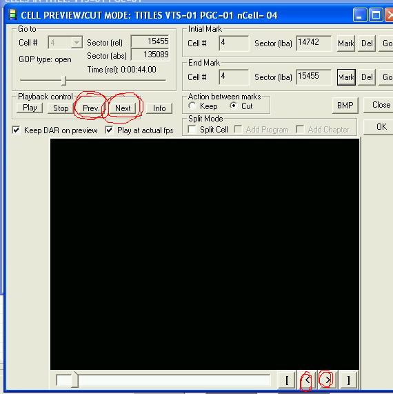

Then use VobBlanker, as Baldrick suggested.I would prefer to avoid that.
Open the DVD in VobBlanker and click on the video in the top screen so that it appears in the bottom screen. Highlight it in the bottom screen and hit "Cells" to the right. In the new screen find the right cell where the cutting is to be done (use the "Prev/Cut" button to the right). Once you've found the right cell, in the Prev/Cut screen, find the beginning of the cut by using the scroll bar, and hit Start->Mark. Find the end of the cut by using the scroll bar and hit Last->Mark. Make sure you tick Action Between Marks->Cut. OK and Apply back to the main screen, give it an "Output Folder" and "Process".
Here's a guide, but the GUI has changed a bit since it was written:
http://jsoto.posunplugged.com/guides/VobBlanker/prevcut/index.php -
OK, I'm trying to ungeek VobBlanker to cut out a short segment of a DVD. I followed the above instructions. I was able to cut a segment, but I have some serious problems. For example, I have about a 2 second segment that I want to cut. When using VobBlanker to exactly mark the start and end of the cut, problem #1 is there is no sound in the playback in VobBlanker. This is bad because I might want to specifically cut out a few seconds of video and neatly eliminate the words that correspond to the video so that the final edit will not be so obviously altered. Problem #2 is that (referring back to the 2 second cut I want to make) in VobBlanker there doesn't seem to be any frame by frame (or next frame) playback. This makes it very difficult to find the exact location of the cut. In the 2 second segment I am trying to cut, using the "next", "prev" buttons (see screenshot) , if I press those buttons about 3 times, the whole 2 second segment will click by, and I know at 25 fps, there are about 50 frames in 2 seconds, and what I really want is a button that I can precisely select the frame for start cut and end cut.
Unless there is some way to solve these 2 problems, I think that VobBlanker is just no good for me.

Your original request was to to edit out a minute or so of nudity without causing the subsequent timing (subtitle, audio) to become messed up. VobBlanker is ideally suited for that. It cuts on GOP boundaries (roughly every half second). It isn't at all suited for frame-specific cutting. The reason is that unless the chosen frame falls on a GOP boundary, a short part before and after the frame in question will have to be reencoded, something it doesn't do.
So, if you insist on cutting at specific frames, then you'll have to use one of the other MPEG-2 editors, but you're opening up a real can of worms, as you'll encounter the problems already mentioned, and some of your other requirements won't be fulfilled. Had you mentioned that 2-second cut stuff earlier, and needing to have audio and needing to cut on specific frames, I never would have seconded Baldricks suggestion of using VobBlanker for the job (and he probably wouldn't have suggested it in the first place). -
