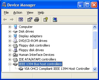

  8. Originally Posted by LVW
    Thanks for the advice this will get me started. How would I know if my computer has a firewire input?
    Open "My computer", and look under hardware properties for 1394 host controller. See picture :
