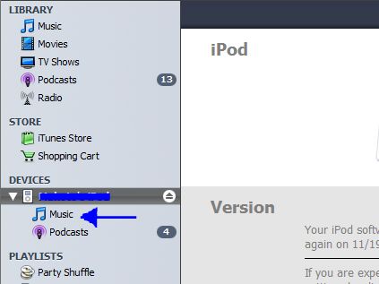

Since I enabled disk use and manual manage first thing on my iPod, I'm going to assume that normally, iTunes handles everything in one single Library. With Manually Manage enabled, iTunes should view your iPod as having its own Library (see the attached picture). You can modify the iPod's Library the same way you would the normal iTunes Library, and they (both the iPod Library and iTunes' normal Library) won't match each other unless you specifically make it that way by copying/moving and deleting songs. Add songs/etc. by dragging them onto the iPod name in the left window pane, from the normal iTunes library or any other source (such as Windows' Explorer).
