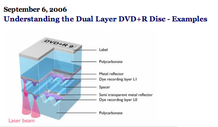

    Verbatims are made with a spacer between the dye layers to fix the distance between layers.
    Explain.

    The spec sheet that comes with the discs I bought showed this diagram. Keeping the distance between dye layers uniform is supposed to allow for higher burn speeds. They are much more difficult to make than a single layer, hence the higher price.

    I was under the distinct impression that *all* DL media is basically made this way. Otherwise, there would be no chance for the laser to stay in focus. Is verbatim claiming that they are the only ones doing this?
    They all have spacers. I don't see any such claim from Verbatim. That's why I asked for an explanation.
    May 2004
    I think they are all made that way, but Verbatims seem to be the disc of choice for dual layer. Fortunately the local Office Max's carry them, so I don't have to mail order.
