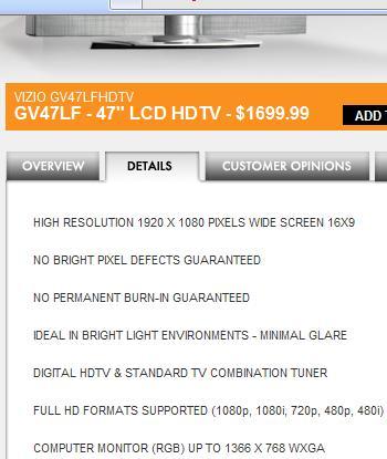

here is a screen. its on the details page on the vizio site under that model, note last line on pictureOriginally Posted by edDV
link here ----> http://www.vizio.com/products/detail.aspx?pid=20
Thanks. That means the VGA port is capped to 1366x768. It's an issue with the processing chipset. That is independent of the LCD panel resolution which still appears to be 1920x1080.Originally Posted by Heywould3
