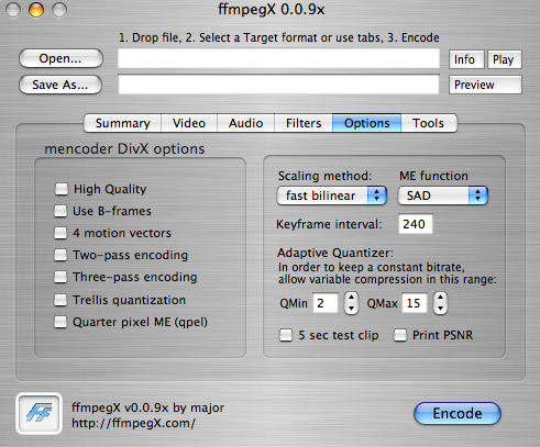

    about the quantizer setting, right now it is set as
    QMin=2 QMax=15
    should I change that?

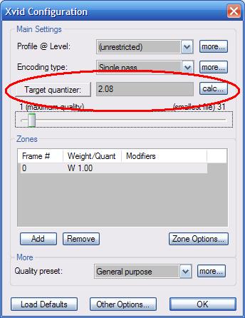

    And for the Quantizer setting, this is the one I mean:

    mine looks like this as Im using ffmpegx

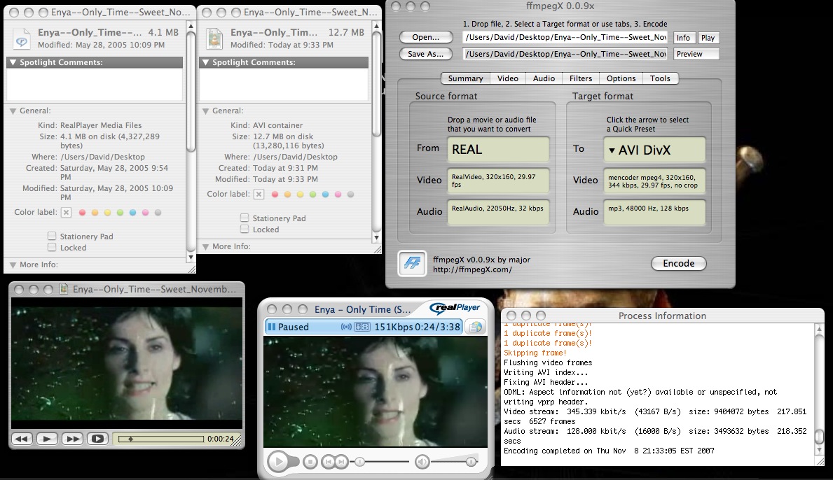

    I have a RM video of Enya that I converted as a test of ffmpegX on Real video. It worked fine.
    The avi is three times the original rm size, but the quality is the same.
    May 2004
    The avi was then handed to Toast. The dvd video ts is now 58mb.
