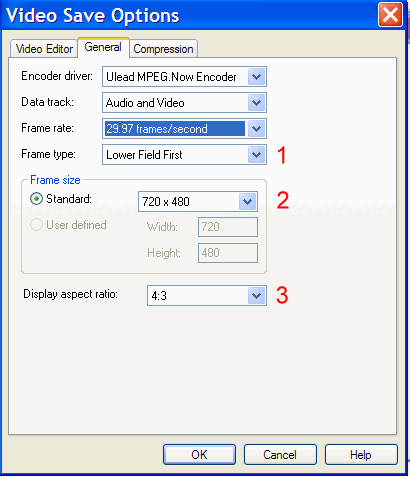

 This is adequate for decent footage. i.e. from a DV cam on tripod or someone with a steady hand. It willgive you about 1.5 hours on single layer DVD. Here's the choices, these screen shots are from Media Studio Pro but should be nearly identical to Video Studio. These settings assume for NTSC, if you're in PAL land you'll have different frame size of 720x576
 1. Frame type depends on your source, if it's DV-AVI from mini-DV cam it's always lower filed first.
 2. Frame size, again depends on your source and what you want to do. If you're trying to achieve the best quality from mini-dv tape choose the native resolution of the DV-AVI, 720x480(NTSC) or 720x576(PAL). Note this is also relative to the bitrate, if you drop the bitrate below 4000 unless you have really good steady footage without a lot of action you'll get better results with a smaller frame size .
 3. Sets the display aspect, this relative to your source.

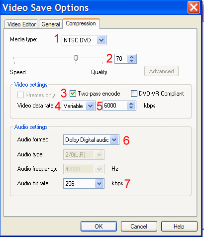

 1. For DVD compliance choose this, it limits your selections such as frame sizes to within the DVD spec so you don't screw it up. :P The MPEG2 selection only unlocks the different frame sizes and other selections and lets you create MPEG2 video that does not meet DVD spec.
 2. To tell you the truth I really have no idea. Seems this really has no affect on either encode time or quality of the video in my testing, I have really good material to work with so it may help with poorer material. Whatever the case I always slide it to 100. Also not it doesn't affect file size in anyway that I'm aware.
 3. Two pass encode enables the encoder to better distribute the bitrate where it's needed the most. This also has the affect of doubling your encode time. If time isn't an issue always select this.
 4. Again distributes bitrate where it's needed the most, selecting Constant will grey out the two pass encode box as its no longer necessary.
 5. This adjusts the bitrate for the video and has the largest affect on your overall file size. If you want to go below 4000 and experience macroblocking change the frame size. As general rule for single layer DVD: 8000kbps for one hour , 6000 for 1.5 hours and 4000 for 2 hours .
 6. If you're using Video Studio 9+ or one of the older version with the AC3 plug in you'll have a selection for Dolby Digital (aka AC3) , this is the preferred audio format. If you do not have this selection use MPEG audio instead. The LPCM is uncompressed and produces enormous files as mentioned above.
 7 Select your audio bitrate.
 The settings above will produce very good results for half decent source material from mini-dv, if you want absolute best results use 8000.

	One other thing to note is the framerate in the first image also assumes NTSC, it will be different for PAL.
