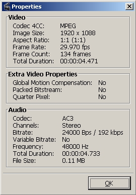

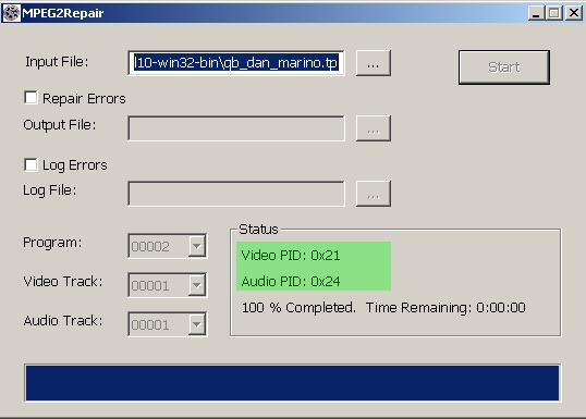

The TP file you pointed to uses PIDs 21 and 24. Set VideoRedo to output TS at those channels. Other properties:
The audio might have to be AC3, but I doubt it has to be only Stereo (2channel) AC3. It would be kind of silly if it didn't support 5.1 audio.

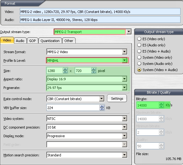

After some fidgeting around with TMPGenc I got the audio to work along with the video. Looks and sounds perfect. The freezing after some time problem still occurs. I checked Mpeg2Repair and it found no errors.
Below is the clip I am playing with.
http://wc3campaigns.net/tim/mp80s/POTC.tp
It freezes on the box after about 10 seconds. No shuddering or other visible video problems.

Downloaded it. Looks correct to me, unless it MUST be 1920x1080 due to a hardware requirement of the player.
Mpeg2Repair Report:
Sequence Frame 1547(6-B) / Time 0:00:51 :
Info: End of MPEG2 sequence
Sequence Summary:
File Size Processed: 89.82 MB, Play Time: 00h:00m:51s
1280 x 720, 29.97 fps, 14.00 Mbps (14.00 Mbps Average).
Average Video Quality: 57.00 KB/Frame, 0.51 Bits/Pixel.
AC3 Audio: 2/0 Channels (L, R), 48.0 kHz, 192 kbps.
Dialog Normalization: -31.0 dB
0 of 1547 video frames found with errors.
0 of 1613 audio frames found with errors.
0 corrupted video bytes in file.
0.000000 seconds of video timestamp gaps.
0.000000 seconds of audio timestamp gaps.
That should work just fine. It plays on my HD hardware decoder. I even noticed your set the PIDs correctly. Did you try any of the M2T files I pointed to above?

Okay so just to close off this thread, thank you so much Soopafresh for all your help and recommendations. I now have full length 720p videos playing seamlessly on my HDTV. I used TMPGenc to convert to MPEG2 then used VideoRedo to convert the MPEG to TS and renamed it to TP. Everything is perfect.
