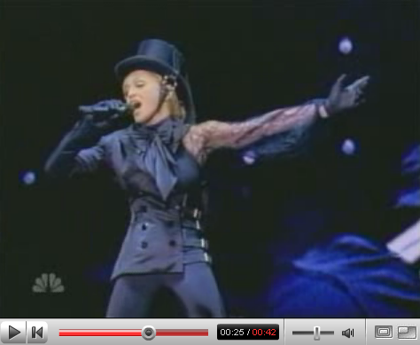

Ok. Remembering I said that this was from a vhs recording done with EP mode
set, which included my vcr's SuperVHS-ET mode..
The source is a 42 second (no sound) short clip.
So now I finally finished up on a 2 1/2+ hour filter process on this noisy
EP recorded video of Madonna's confession tour concert, as recorded back
in nov/2006, then captured and encoded mpeg-2, lost it on HDD, found it
today, vfapi'ed it over to virtualdub, then avisynth, then back over to
virtualdub, then put through an arson of ffmpeg -> flv (for youtube)
then was decided it needed some more pampering (filtering) ran yet another
though through a quick filter, finally to another new_avi, and then
ran even some more ffmpeg -> flv (for youtube) encodes, finally met up
with youtubes bitrate limit nonsense and was happy enough (by now, my
eyes are rolling out of their sockets) and I'm ready for shut-eye, though
am on last steps of uploading it to youtube (as I write this, it is 63%
finihsed) and then I want to make sure it is untouched by youtube, so I
have to download it first (else, I'll delete it if it is, cause its not
worth demoing if youtube [s:ab8392007e]screws around with it[/s:ab8392007e] re-encodes it) but
I'm quite sure it will go through untouched.
Here's how I feel
's
And now, I unvail the drooling demonstration of an vhs (EP) video recording
from my analog cabletv which was ran through various NR processes, some
of which were 2-pass applications plus several new avi's in the process
(for vhs, [in my projects] these are necessary steps) -- and my upload
is still going strong, now at 98% complete, via dial-up.., oh, and it
just completed, hehe.. now to test to see if youtube touched it.. oh,
and a quick glance at the size, and I can see.. it didn't touch it..
now I'm really happy, cause all the work paid off, hehe..
Thus, here's the result of all that crazy work:
.png)
Thats the way called it. And good night
From the Video Workstation of,
-vhelp 4429 -
