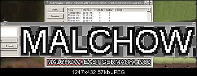

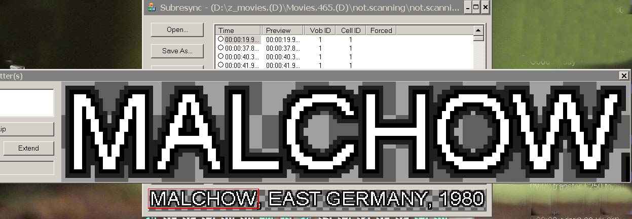

  18. This is what I see in Subresync

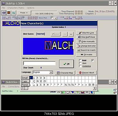

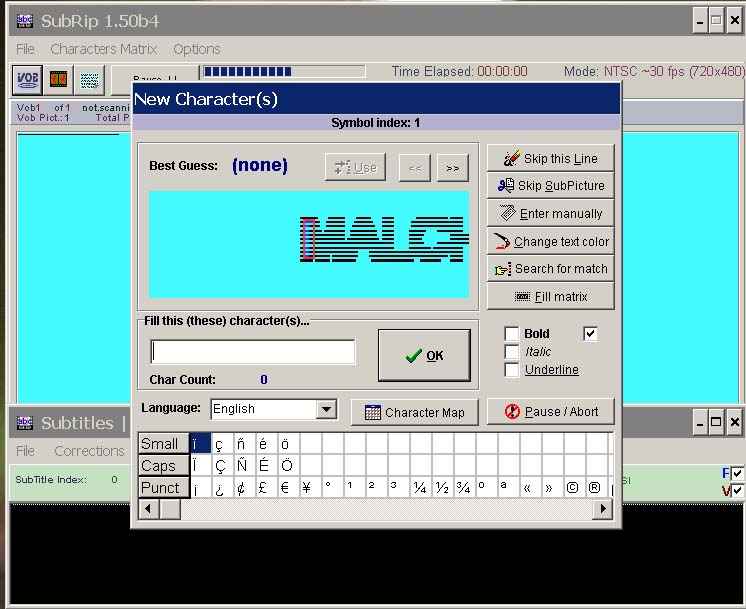

    and this on Subrip
    So when I try to adjust the colours the program says "can't process text".

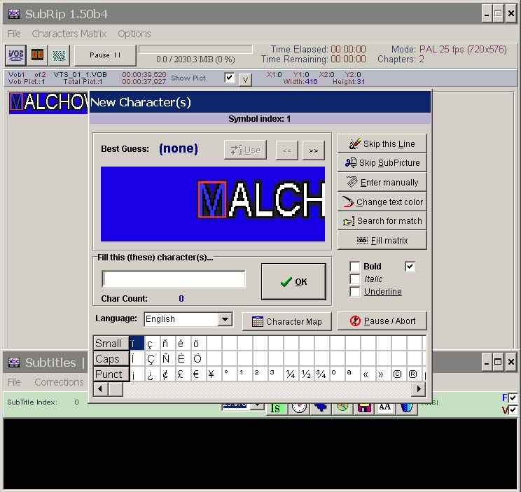

    This is what I get AFTER conversion with "ConvertX2DVD"
