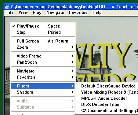

VirtualDub uses VFW rather than DirectShow for decompressing video. MPC uses DirectShow. VLC uses its own built in decoder. You need to find out what decoder MPC is using. Once a Divx4 video is playing select Play -> Filters and you'll see what decoder is being used.Originally Posted by DRP
Xvid can decode Divx4 but I have seen some versions crash with some files. Try a newer version fo Xvid if you have an older one. Or install the latest Divx. -
I don't know how I can do this without being able to get it to play in the first place.Originally Posted by jagabo
I'm using the XviD version included with the latest AutoGK which is quoted as being v1.2.0 CVS 20/12/06Xvid can decode Divx4 but I have seen some versions crash with some files. Try a newer version fo Xvid if you have an older one. -
It crashes too when I press the 2 button. Here's a screen capture I took before Windows closed the program. Does this help identify at all what's going on? I don't know why it's trying to use ffdshow to decode the video. I have ffdshow installed for sure, but the only codec that's enabled for use is the FLV1 codec. That's all I use ffdshow for. Everything else within ffdshow is switched off so it shouldn't even try to use it at all. XviD should be doing the decoding.
