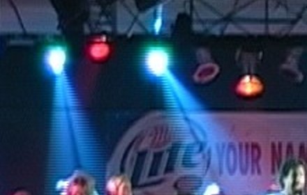

    Your monitor is a progrssive display, the video is interlaced designed for playback on a TV.
    Interlaced:

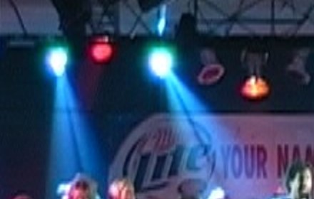

    This loooks like shit when played back on monitor but outstanding on a TV. The software deinterlaces video on the fly producing this:
    There's a few methods of getting from the first image to the second one, some deatail has to be removed then recreated through interpolation or duplication. Note how the second image looks slightly softer than the first.

    Okay so in VLC for example and other players I should be using Deinterlacing? I'm trying it now and different deinterlacing options in VLC are looking different, though I can't see that much of a difference.
    For playback on a monitor yes, for creating DVD's tobe viewed on a TV no.
    Well you're going to get varying result but they all do basically the same thing but approach it in different ways. Basically you throw half the resolution away (i.e. every other line) then try to recreate them. I'm not sure there is anything you can do to "fix" this beside buying a interlaced monitor which I'm pretty sure doesn't exist.
