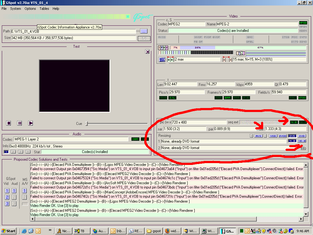

    Now, I've finally gotten the videos, and they seem to be authored in the wrong aspect ratio. The original video was indeed natively 16x9, but the DVD's he keeps giving me are pillarboxed on my widescreen set. Opening it up in GSpot reveals the VOB is indeed in 4:3.

    So, oh great video gurus... How can I convert the VOB to widescreen WITHOUT cropping the video? As I've said, the video just needs to be stretched to be properly formatted...
    Just a note, the resolution is currently at 720x480. I'm assuming this is not a mistake. From what I understand, many widescreen DVDs are natively 720x480, but with rectangular pixels.. Should it be 853x480 instead, or is that not necessary?

    (I've attached a GSpot display)
    Copy the DVD to your HDD and then use IfoAR2WS. Try play with a software player and see if it looks better.

    It sounds like the video is OK but the A/R flags need to be changed. I don't know the exact steps, but IFOEdit should be able to change the flags without having to re-author the whole disk.

    And IfoAR2WS does that also.

    Worked great as far as I can tell.. thank you!
