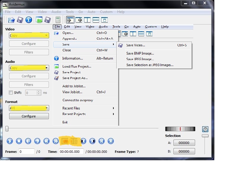

  8. Doesn't vdub require acm codecs installed? I'd use avidemux cut edit avi/mkv /mant formats without re-encode. Just set Audio>Copy Video>Copy Set Container press file save as djbhdsf.avi or whatever container, and to cut press A for the start and B button for the endClick image for larger version

    Thanks for the info.... I am trying avidemux. Considering that I do not want to re-encode, does it matter how I answer this? It popped up when I opened a video file.
    Name:  Avidemux question.JPG

  10. Always Watching guns1inger's Avatar
    Apr 2004
    Miskatonic U
    Unpack it. It won't affect your editing or saving
    Read my blog here.
  11. I never unpack it as it disables video editing if I select avi unpackVOP but if it works for you the ok
