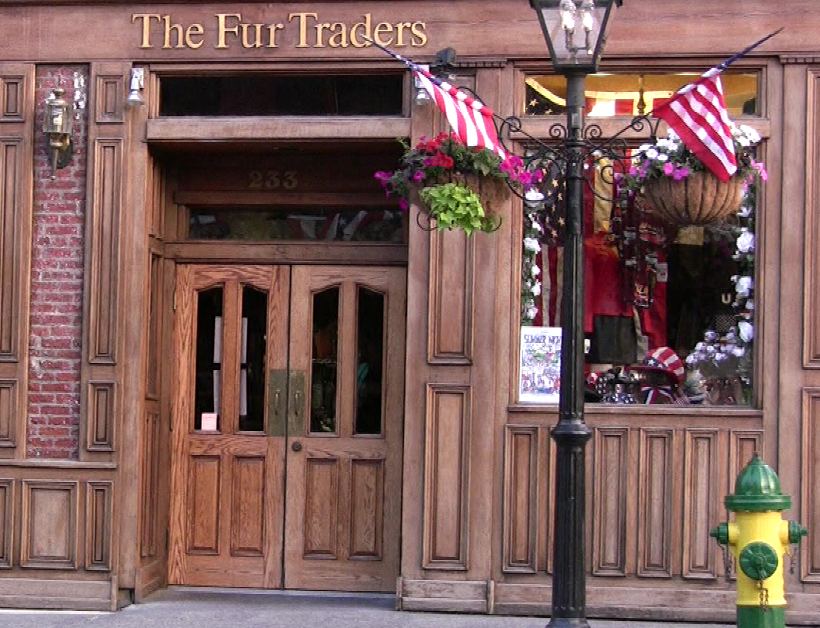

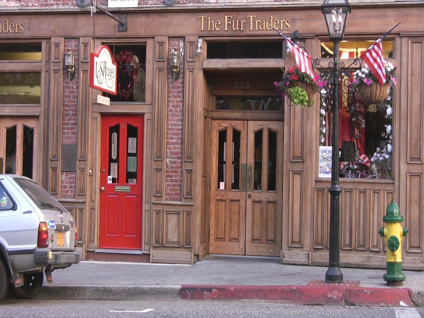

	Can you post a full size frame cap?Originally Posted by terminalh
 You can cap a frame in VLC. Under Video. Set Deinterlace to BOB first. Here's a 1920x1080 HDV example shot around sunset and captured to Vegas 6d.
 xxx
 OhOh 2MB upload limit. I'll have to use quarter size 960x540 instead.
 This is an 1157x886 crop out of the 1920x1080 full size.
 (Click on the picture to see full size)
 This was shot under lower light conditions than it looks. Camera sensor grain is evident. The bob deinterlace shows some edge artifacts.

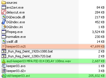

 terminalh - try my m2t to AVI conversion script. You'll need to install the following:
 Avisynth 2.58
 lagarith codec
 m2t_preprocessor_lagarith_v2.zip
 1) Place M2t in same folder as unzipped files and click .BAT file for desired output resolution
 2) Import the resulting AVI and WAV file into Vegas (don't worry about the delay number in the wav file. It gets fixed by the batch. The A/V should be in good sync.
 It will deinterlace the picture as well. Let me know if you want to bob deinterlace instead, it's just a single line modification to the batch file.

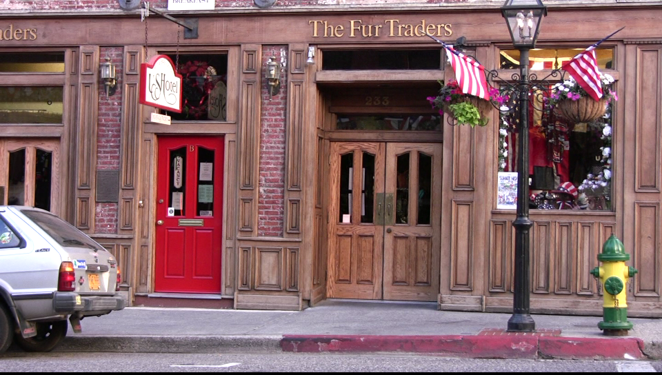

	Here's an even higher quality version which uses a hybrid deinterlacing method (nnedi + yadifmod) to create even cleaner looking video, at the expense of speed. It's a lot slower. Looks very good, though. You'll want to run the .BAT files with the _HQ suffix.
