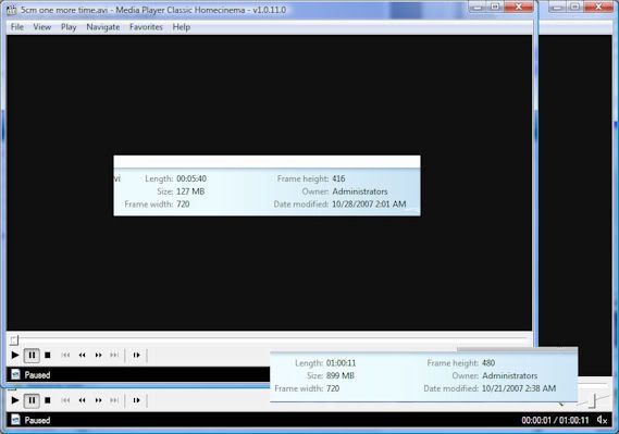

Here is what I'm talking about. They are both frame width 720 (according to windows), but one window is clearly larger both width and height-wise than the other by what looks like a rather wide margin. The upper left information box shows the smaller window to be 720x416 resolution, while the lower right box shows the larger window to be 720x480 res.
When I play the 720x480 video on my 16:9 tv it fits the screen perfectly with no black bars, but when I play the 720x416 video, it leaves small black bars on the left and right side. Again I want to note that the original DVD from which I'm trying to rip from will fill the screen exactly. -

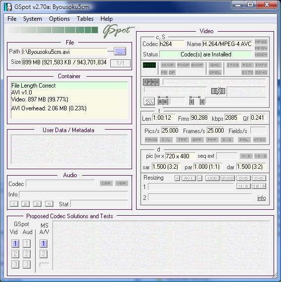

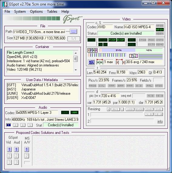

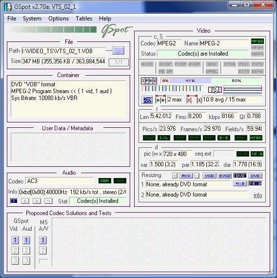

Sure thing...here they are. I guess maybe I was a little misinformed about the 720x480 avi file I had. Where the VOB says 16:9 for "dar", the 720x480 file says 3:2... However they still show up as the same size window and both fit the 16:9 screen perfectly. Lol sorry about the noobness on my part. I only see what's on the surface. The 720x480 avi file was extracted from a MKV file using MKVextract, so that I could work with it in Premiere.
Here's the gspot for the VOB file:
Here's the gspot for the 720x480 avi file (It does not show any information for audio because I opted not to extract it from the MKV since I will not be using any of the original audio in my project):
And here's the gspot for the 720x416 file that I tried to rip from the VOB:
