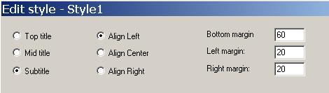

Hehe, I knew this was going to happen. Don't worry, there's only one more very easy step to complete to get the colors just the way you like them. And in the future, if you do this again, just use the default colors in MaestroSBT.Hi Manono, everything with MaestroSBT seems to work, except I can't get the colours right with MuxMan! The default colours don't come out right, so I change them on the MaestroSBT Rendering screen.
There are 2 easy ways to change the colors. One is faster. Open the DVD in PGCEdit, double-click on the movie in the left window, and in the new screen that opens up you'll see the CLUT (Color LookUp Table), the 4x4 block of colors. You should see your 3 colors in the top row. Change the main color, anti-alias color, and the outline color to whatever you like, OK back to the main screen, Save and test.
The other way takes a minute or so longer to do, but there's a nice guide. Open the VOBs (all of them at once) in DVDSubEdit, and follow this guide to get the colors the way you want:
http://download.videohelp.com/DVDSubEdit/Guides/ChangingColors/Guide.htm
But otherwise everything is good? The subs are in the lower left of the screen, and they don't flash or blink when changing? -
