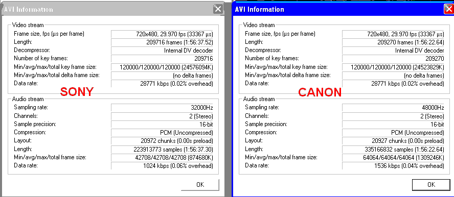

Okay, rock this on for size.
I recaptured the same tape from two different cameras. The only difference is that the Sony outputted with 32000Hz audio and the Canon outputted 48000Hz. File sizes are 23.5ish GB. I did a quick short encode of each and the Sony had non-slow sound. Who knows if it was perfect sound, given the problem, but it didn't sound slow. The Canon one (the one with 48000Hz audio) had slow sound. Does this help anyone figure out what the deal is? I don't really want to get all complex and fancy by doing what redwudz suggested.
^^^The picture is VirtualDub data. -
