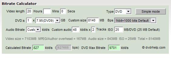

Lets test something.
Assumptions:
- Lets assume quality/viewability is not an issue.
- Assume max capacity on DVD (DVD-9 DL)
- 352x240 Resolution
- 20 Hours of video at 400kbps
- Also assume this doesnt have to abide by DVD compliance, BUT it is an MPEG1 or MPEG2 so we aren't using some other codec compressor
- Lowest possible audio bitrate but still audible to the ear without causing screeches that will make you bleed
just for safety - lets make it 48kbps instead of the minimum 32kbps.
Now for the logical math (please double check for accuracy) using TMPG filesize estimator,
Filesize (Kb) = (Video+Audio)Bitrate (kbits/sec) x (2048/2018) x movie lenght sec/8
simple math to find out the size instead of bitrate:
20 hours = 72000 seconds
Size = (400+48)kbps * 1.0149 * 9000
Size = 4092076.80000 kb
Size ~ 3.903 GB
800kbps ~ 7.387 GB
1200kbps ~ 10.871 GB (normal VCD bitrate)
What do you know it does fit on one DVD-5 disk at 400kbps, double bitrate for DVD-9. So its possible which we have been telling. Its viewable, but DEFINATELY not a standard that professional would use... therefor conclusion:
Yes, its possible 20 hours on one DVD disk, if you dont care about quality. However, it is still a bootleg no matter how much sugar you put on top! Unless you are saying your professionals live by a standard lower than that of global DVD standards. I'll post some sample images in a few min. -
This is what I got:
Use 352 x 240 VCD format and it might be OK for a low resolution video. A DVD-5 would be half that bitrate and would definitely suffer.
And while the numbers say it's possible, you'd have to use non-compliant tricks to make it "look good" (which is still a far cry from good, but not as bad as something more compliant).

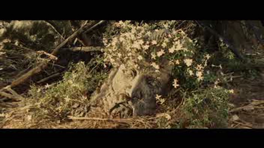

Here are the pictures
This one is what i'm assuming it'd look like at 400kbps viewed on 704x480 standard TV
