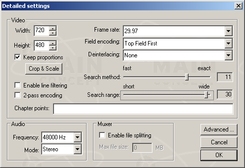

	I like MainConcept v1.5 standalone encoder and TMPGEnc. MainConcept has Hi-Def presets that are fully compatible and HDV compliant. TMPGEnc can output Hi-Def resolutions, but are not HDV compliant. Either one would be a good choice for SD DVD resolutions.
 If you go with TMPGEnc, use "RGB24" in the Degugmode settings. For MainConcept, use "YUY2". If you go with MainConcept, set "Noise Sensitivity" to 5. I use CBR @ 8500 kbps and details settings like this:
