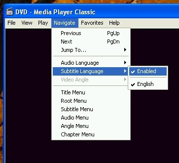

What do you mean - what subtitle indicator? Post a screenshot, that might tell us more.Then I tried to play the file on Media Player Classic and the subtitles could not be seen. The subtitle indicator was illuminated, and could be turned on and off, but I could not see any subtitles at allIn the beginning the Universe was created. This has made a lot of people very angry and been widely regarded as a bad move. -
To answer your questions, I haven't tried your way (MaestroSBT) to process subtitles because I am trying to get familiar with this one way, and learn how to use this way correctly, before I try another way. That is correct in saying the burned DVD playing on a standalone DVD player is the final test if the DVD is working correctly or not. So later today I will burn the DVD and see what the result is. However, I would like to come to the bottom of this discrepancy between DVDSubEdit and Media Player Classic. I decided to do another experiment. (By the way, when I say "subtitle indicator" in Media Player Classic, I mean that it is possible to enable subtitles, in other words, the option is not greyed out. See screenshot.) This time I opened all the vobs in DVDSubEdit and moved just the first subtitle up vertically to just line up with some video. I save the change and looked at the result in Media Player Classic, and that one subtitle had completely disappeared. (Before the change, the subtitle was displayed just fine.) Boy, I am glad I did not move all the subtitles. I then looked at the result in Power DVD and the subtitle was displayed, and moved up vertically, no problem. When I look at the vob again in DVDSubEdit, the subtitle is there and moved up. DVDSubEdit is definitely changing something in a weird way so that Media Player Classic doesn't display the subtitles. Something isn't right and I would sure like to know what it is. I will burn the DVD and then see if that first subtitle is displayed on the TV. See screen shot of the first subtitle that I moved up just to the video. The one that just disappeared.

I am using Media Player Classic and opening the Video_TS.IFO file. I've played dozens and dozens of movies from the hard drive and from the DVD and never had a problem displaying subtitles with Media Player Classic. When subtitles are present in the movie, Media Player Classic will have the subtitle option illuminated (see screenshot in this thread). I am still looking for another easy software to raise subtitles in the VOB. I find it hard to believe that Media Player Classic is at fault. Also, if somebody has a movie with subtitles on their hard drive, could you please raise the subtitles with DVDSubEdit and let me know if you can see the subtitles when playing with Media Player Classic? Maybe I have some kind of strange codec problem. I don't know what other software and codecs are being used in the background automatically.
