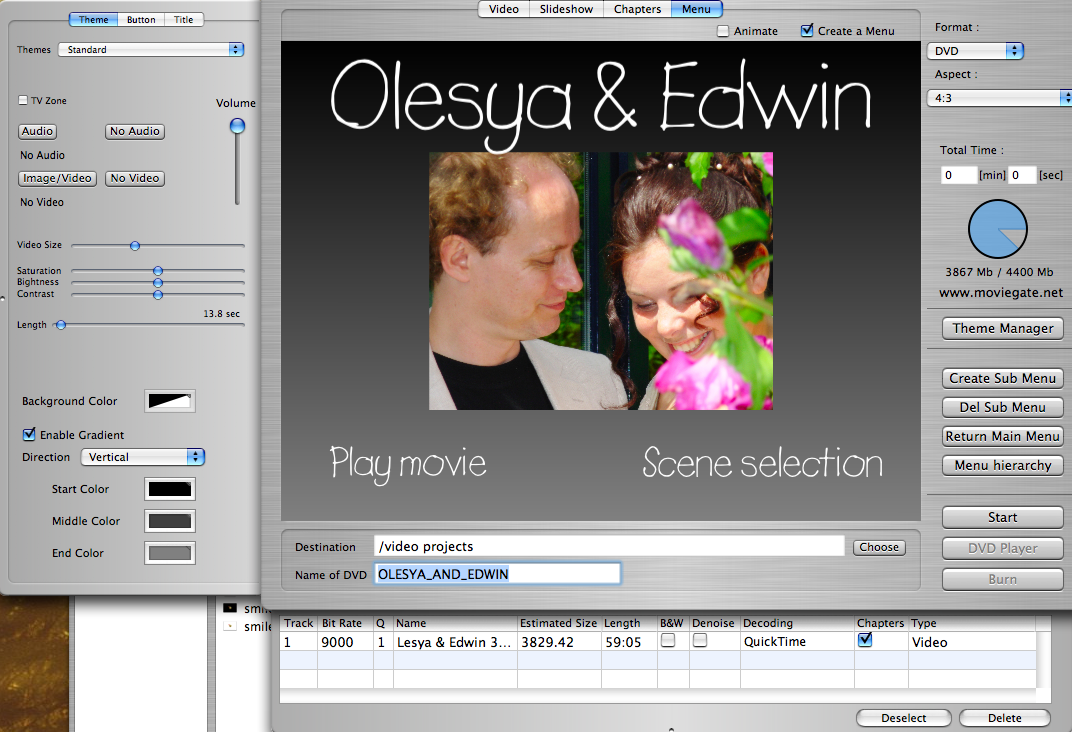

    See the attached snapshot. What I want is to link the button "Play movie" to the movie, and the button "Scene selection" to, obviously, the scenes. I also want to call the scenes as they are called in the film
    Quote Originally Posted by Herve
    specify the title, position of your thumbails, or import a new file
    So here I have the problems. I just don't get the logic of "title" and "submenus" within this program. (see other snapshots here: http://afkatja.spaces.live.com/photos/cns!251A47471B66BD0F!133/)

    Quote Originally Posted by SuperMole
    Uhm... let's say I only want a button like "Play movie" that links to the film, forget about chapters and scenes. I make a submenu,
    no need for un submenu (you just have one button - the movie)
    (Otherwise the "Button" tab is all inactive, see attached snapshot.)
    each button = a different track
    to modify one button, you must select it: clic on the thumbail or clic the track in the list below, (every time you add a video, the list display it, if you want to select a track clic on this list, same behavior as chapters).
    PS: at home when I select a button, the thumbail becomes red (depends of your preferences)
    Is this correct?
    sorry no idea of what you did, seems you have only one video track, 2 buttons in the main menu, 1 button in an other submenu? Don't manage to see more with your snapshot
    What is command line dvauthor (accessible via Terminal? )?
    oops, dvdauthor
    such a simple task of making a DVD with menu and chapters AND subtitles (not available in iDVD) costs so much effort...
    not a simple task without a GUI
    I don't know why you didn't succeed (maybe some problems with ergonomy or tutorial?), my last attempts were easy, but I didn't try with the last version.
    bye
    All right, I export the film and subtitles, then go to the button tab and it's deactivated, cannot edit anything. I right-click there and choose "Add selected track to the main menu". I see the thumbnail, when I select it, it also becomes red. I don't need submenus or whatever, I just want (as simple as that) a film with subtitles and chapters. Then I click start and voila.... a menu, which leads to nowhere, a black screen with title "My DVD" (which is a submenu I didn't edit). So really disappointing, this was my second try with same result. Giving it up....
    By the way, the .mpeg file created by mpegstremclip could not be read by ffmpegX (using mpeg2enc codec; ffmpeg codec deactivates subtitles so not an option for me).
    I would agree now to something very simple, just the film and subs!
    Ergonomy of the MovieGate program? It's just very very unfriendly... (or am I seeing it too difficult?)
