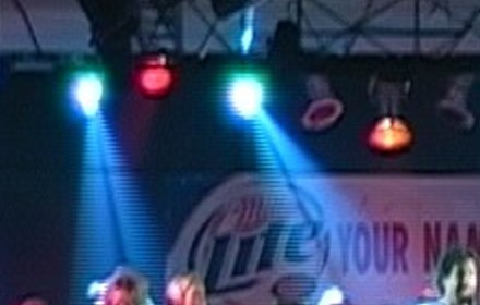

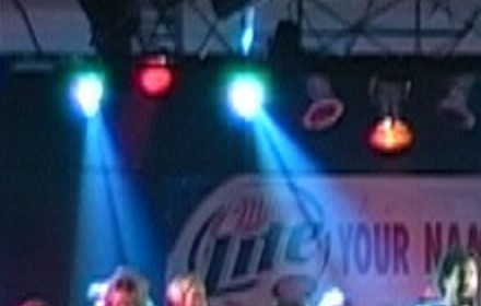

The first thing you mention is most likely the overscan area which is normal whichcan't be seen on TV, for playback on a TV just leave it there or mask it. For computer playback you can crop it. The second thing is most likely interlacing and again is normal. You won't see this during playback on most software players because they deinterlace on the fly. If it looks like this, that's what it is.as well as about 5 pixels of distortion in the top of the frame. VirtualDub has a crop feature that let me crop out 12 pixels on each side, and it made the video look fine - but like I said, after export, it would have these nasty black lines.
You can apply a deinterlacing filter in virtualdub which will give you result like this:
Note that deinterlacing is destructive process, you are essentially throwing half the resolution away. It should only be done to video that is intended for playback on computer,phone , ipod etc .. or in you case if you're going to upload it to youtube.
