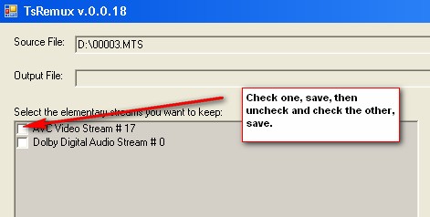

Ah, actually I recall an easier way. Tsremux . No promises, through. BBC HD h264 TS is a tough cookie.
BTW, I converted this 10 sec clip: http://mirror05.x264.nl/public/force.php?file=./beyonce.at.the.bbc.1080mbaff.sample.ts
to DivX 640x352 in Winmenc. Perhaps the source file characteristics are different from yours ? -
Thank you Soopafresh, I think we're getting somewhere!
I can demux your Beyonce clip and one of my test clips using Tsremux.
