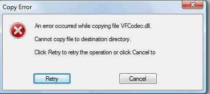

    I just found this guide a few days ago and I have been following it. I am stuck when using virtualdub I get the same "Couldn't locate decompressor for format 'vifp' (unknown)
    VirtualDub requires a Video For Windows (VFW) compatible codec to decompress video. DirectShow Codecs, such as the ones used by Windows Media Player, are not suitable" message. I've tried double clicking the vifpset.bat but then I get
    I also tried to just copy and paste the files into system32 and I still get the same error. Lastly, in the begriming I was able to create a D2V file and a AC3 file by setting Audio to Demux all tracks in output method and not Demux tracks as was suggested, just letting you know what I've done so far. TIA
  9. VH Wanderer Ai Haibara's Avatar
    Jan 2006
    Somewhere on VideoHelp...
    Since you're using Vista, you probably need to run the .bat with admin privileges. Right-click on the .bat file and pick "Run as administrator". You'll need to have the admin password for your system handy.
    Nov 2005
    I did it but I'm still getting the same error.
