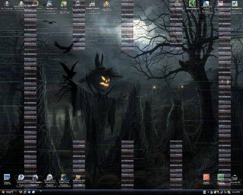

Booted up a few minutes ago to this.

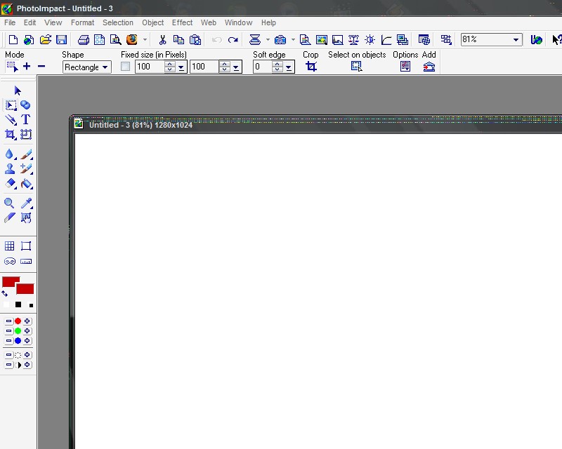

Opened Photo Impact to do the screenshot and after minimizing it looked like this.
Changed 32bit to 16bit and back and it cleared up the desktop but Photo Impact still has residual images in it.
Resetting Window Blinds took care of that part of it. Now that it's up and running it no longer has the issues. It mainly seems to do this when I boot up. -
