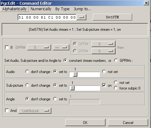

  6. It's easy enough to make a subtitle play with a specific audio language with the use of a SetSTN command. Open the final DVD in PGCEdit and right-click on the audio menu. Highlight one of the audio language commands (make the box around it green), click on the current command itself in the big rectangle below the picture of the menu and in the new 'PGCEdit - Command Editor' screen go Alphabetically->SetSTN. Make sure 'constant stream numbers' is ticked (instead of GPRMs). Set both the audio stream number and the subtitle stream number the way you like. 'OK' and do the same for the other 2 languages. Streams begin with the number '0' so the first one is '0'. When you have all 3 set the way you like, 'OK' and 'Close' back to the main screen, 'Save' your work, and test it in a player before burning to disc. If you screw up somewhere, restore the automatically created backup and start over again. Below is a picture of what you're doing in the 'PGC - Command Editor' screen:

  8. You're right; I didn't understand. I thought you would be doing this through an Audio Menu
    You can set a default audio language and subtitle language easily enough. Highlight the movie, right-click on the pre command over on the right side, and 'Add After'. Double-click on that new NOP and then follow the instructions from before to set the default audio and subtitle language.
