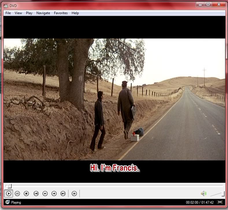

Hi, I registered too in this great forum I found, I wanna thank you first for the amazing guide, it did worked for me, but I want to ask a little help here, the DVD plays well with subtitles I added, somehow it appears with red color and horrible shadows like this: http://i1186.photobucket.com/albums/z374/hackers1303/Scarecrow_1973_DVDRiP_KonzillaRG/...bsproblem1.jpg
I read comment above that using PGCEdit will fix it or using DVDSubEdit, and the other problem is that when I scale the movie to full window "Touch window from outside" the subs then, don't appear, look, same frame: http://i1186.photobucket.com/albums/z374/hackers1303/Scarecrow_1973_DVDRiP_KonzillaRG/...bsproblem2.jpg
What can I do to avoid subtitles's position being affected by scaling video? The DVD release is PAL 720x576 16:9 from germany but Muxman says "Actual: PAL 720x576 MPEG-2 4:3" it came with german subs but I replaced it with english subs. Can anyone please help me? I also used DelayCut to fix the AC3 because demuxing it made my sound delay by some miliseconds. Thanks in advance. -
Ok, I managed to change subtitles colors successful with SubtitleCreator and I also fixed position by saving the SUP file selecting Display -> Video Format -> PAL, and the subs are now visible whenever I scale movie to full window or scaling it to 16:9, but now I need help with sync, can you please tell me or recommend me? like details like convert frame rate,etc? I think that it is needed to have the same frame rate (like 25 fps or 23 fps) I need some help with this. Anyone?
