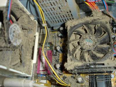

Many thanks for all your replies. Gold stars go to those that thought the cpu over heating was the problem.
I "finally" got around to checking and the heat sink looked like one of those huge fur balls you saw when emptying an old vacuum cleaner bag.
Again many thanks to all. -
Sort of like this?:
There's good reason to check the internals of your computer on occasion.
(And thanks to the member that posted that picture.
Youv'e probably already cleaned it out, but I would do it outdoors and wear a dust mask. You don't really want to breath that stuff.
