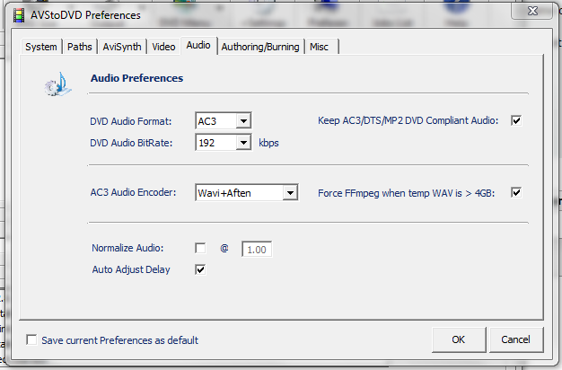

    Hey there! I converted this MKV to DVD using AVStoDVD, but the audio was out of sync. Here are my settings.
    Interestingly, converted it via ConvertXToDVD and all was well.
    P.S. The audio from the MKV was DTS

  8. Originally Posted by djdelarosa25 View Post
    Please post the AVStoDVD project log file.
    Bye
    MrC

  9. Member manolito's Avatar
    Jun 2009
    Germany
    I bet it's the old M$ DirectShow filters issue again...
  10. Originally Posted by manolito View Post
    And you will easily win...
    Bye
    MrC
    AVStoDVD Homepage

  17. @djdelarosa25
    thanks for reporting the log file. Very likely it is a directshow codecs issue.
    See Help/FAQ/General/Q1.5 and, in case, Help/FAQ/GUI/Q2.7
    Bye
    MrC
    AVStoDVD Homepage
  18. Member manolito's Avatar
    Jun 2009
    Germany
    What's interesting is that ConvertXToDVD delivered better quality and at the same time, did the conversion a lot faster than AVStoDVD (it was really noticeable, AVStoDVD had a lot of pixelation). Strange.
    There must be something wrong with your settings then. ConvertXtoDVD uses FFMpeg for encoding, either in a Constant Quality 1-pass mode or in VBR 2-pass mode. It is hard to believe that it delivers better quality than HCenc in 1-pass or 2-pass VBR mode when using identical output settings (bitrate, frame size etc).
    If this pixelation still occurs after configuring your DirectShow filters correctly (LAV is the preferred method today), then some further analysis will be required...
    Cheers
    manolito
    //EDIT//
    Just noticed that you kept your DTS audio track which has a bitrate of 754 kbps. This causes a very low video bitrate of 3105 kbps. You can specify to reencode audio to AC3 (either 6-ch or downmix to stereo) to get a higher video bitrate.
    //EDIT2//
    I already deleted the original project log that was converted with Wavi+Aften as the AC3 Audio Encoder. Tried to convert it again with FFmpeg (Safe mode) selected, still same results. Here's the log. Wasted two hours of my life.
    Not true. Your log clearly shows that you used HCenc and not FFmpeg safe mode for video. And for audio you specified to keep DVD compliant audio tracks, so your DTS audio stream was not touched at all.
    And I am sure everybody here on this forum is very sorry for the precious time you wasted... (Do you have an idea how much time other people wasted for helping users like you? Not to mention how much of his lifetime MrC wasted for writing this software)
