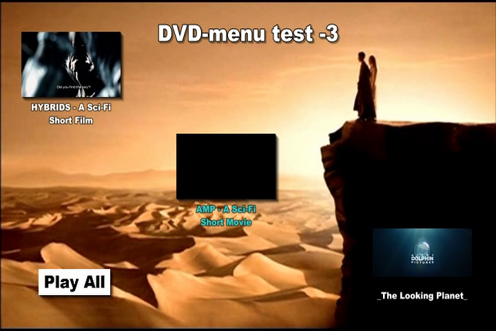

    here you go
    i loaded 3 sci-fi shorts, chooose a random background picture, processed all the way to the saved DVD folder
    opened file with vlc, motion menu, all links are correct, played perfectly

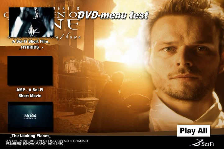

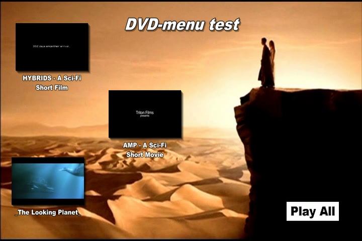

    this works fine, no problems, is your problem there when you process this to a DVD folder
    i am processing all the way to dvd folder, this ver 2.6 does not do active menu preview testing of menu functions
    also i have max titles per row at 4 even though there are only three in this test
    the max i have ever put on a disc is 6,
    and i have re-arranged them all over the menu page and never had a LINK problem

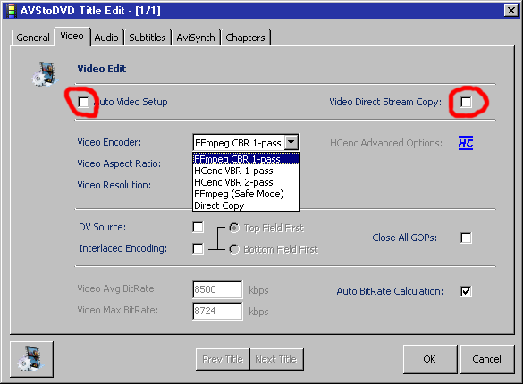

  11. Member manolito's Avatar
    Jun 2009
    Germany
    Originally Posted by abrogard View Post
    I was told to use AVStoDVD and uncheck the 'direct stream copy' in the video menu but I can't see any such choice to uncheck.
    Is there some way to burn this onto DVD5 and compress or perhaps split it over two disks, with AVStoDVD?
    Hi abrogard,
    of course AVStoDVD can reencode a source to fit on a DVD5 blank.
    Load the source, click on View/Edit Title settings and select the Video tab. Uncheck Auto Video Setup and Direct Stream Copy, then select your preferred encoder.
    Make sure that you have set your output DVD size to DVD5.
    Cheers
    manolito

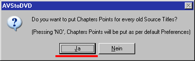

    Only problem is, A2D does not insert a chapter point
    at the start of each clip within the title.
    Is this something that may be possible to implement? Just wondering ...
    Hi Dave,
    this is already implemented. Did you overlook this message box?
    Works well for me, just one catch: The chapter points will be off if a frame rate conversion is involved in your encode.
