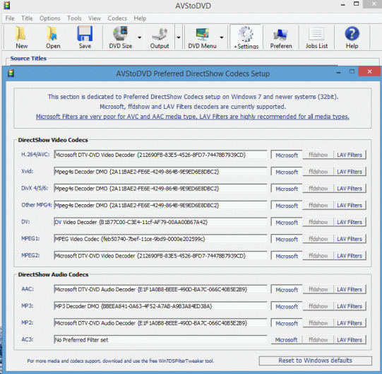

    Here's a picture. I really can't tell if they're "highlighted", or not...

    Then I tried clicking a LAV filter tab but it obviously refuses to change anything...

    I tried to install LAV Filters twice. One while checking the "reset" box, once without, same result. The Microsoft filters can't be changed that way. So I'll have to try your special utility, next...
    Jan 2015
    N.A.
    Your special utility worked except it left AC3 at the bottom without any assigned codecs. However I was then able to change it to LAV Filter by rightclicking the AVStoDVD shortcut on desktop and Run as Administrator, which allowed me to set it with the LAV Filter tab. Possibly that would have worked for all of them, so maybe your special utility wasn't needed. I suppose the graphic below looks OK now (?).

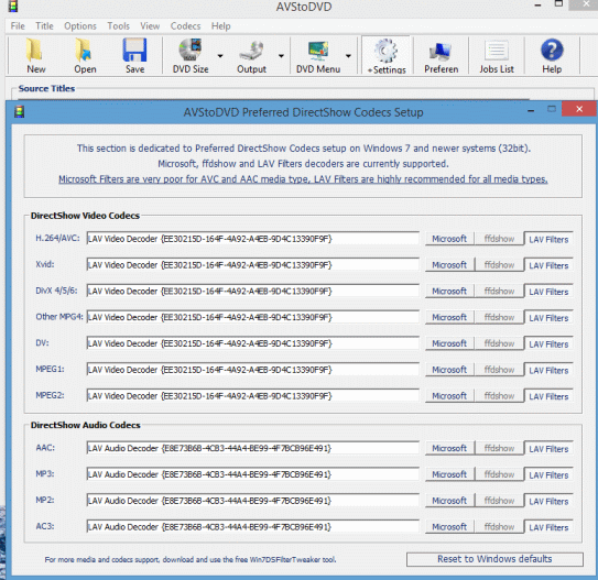

  5. Member steptoe's Avatar
    You are now using LAVFilters. That exactly what happened to me. Microsoft decided its was the only codecs in existence and refused to accept anything else was better so had to be forced to change to LAVFilters, just like yours were.
    Load up AVStoDVD, add your source video as normal, on the right side on the main window are four icons. Click the one that has a gear wheel and it will bring up another window titled AVStoDVD Title Edit. Now click the tab that says AviSynth. That will change to a window titled AviSynth Script Edit. This is the part that does all the work and also where you can add your own filters or functions to give AVStoDVD even more power and control over your video project
    Untick the box Auto AviSynth Script, you should now be able to directly edit the script in the box
    Just after the part that should say Video = Video.ConvertToYV12(), move your mouse cursor to the end of this line and press the return key on your keyboard. All the text should now turn red (I assume to warn you) and a blank line appear below
    In the blank line type in :
    Video = Video.Greyscale()
    The spaces don't matter, it just keeps it nice and easy to read. Now press the OK button
    You should now be back at the main screen with the four icons on the right. Now click the one that looks like a magnifying glass (if you leave the mouse pointer there for a couple of seconds it should also come up saying 'Preview Title Output'). If you get a warning saying about normalize just click the 'Yes' button or you might have to wait a good few seconds
    You should now get a video preview window pop up, this might take some time or it might be straight away but it WILL eventually appear. Press the 'Play' button and you should now get the video you loaded into AvstoDVD playing in the preview window. It should be 100% greyscale. I've just tried it on a non-B&W film and its now a greyscale film, so does work
    If everything went OK, you have just edited your first AviSynth script and added a custom filter
    Run the project as normal and see what happens if its all in sync and full greyscale
    The only real difference that I am aware of between installing AVStoDVD or using the portable is the portable one can simply be put anywhere. Just copy the entire folder. It also makes it easier to upgrade when new updates of AVStoDVD are released. I prefer the portable version
    I also use the very latest HCEnc 0.28 and the marvelous add-on that manolito did to enable custom commands or matrix to be used with HCEnc that AVStoDVD doesn't yet support. The LOSSLESS command in HCEnc makes a BIG difference in speed for slow scripts, but only works with HCEnc 2-pass and the 1st pass needs a huge amount of space. Anything upto 40GB sometimes
    But it just shows what AVStoDVD is capable of by using AviSynth and custom scripts

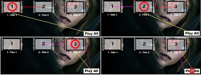

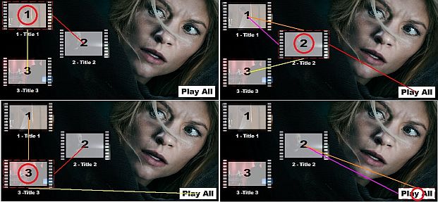

  29. Hello,
    Is there any way to control the hl link association when setting up a menu? I have three titles in the build and I want to arrange the three thumbnails in a staggered vertical orientation so that the background is not obscured. However, as I drag the thumbs around, the hl links go wonky and menu navigation no longer works as expected in the burned image.
    This is how the links are from the menu wizard's default thumb positions:
    This is how the links are after I have re-positioned the thumbs to the desired arrangement:
    As you can see, the links are very wrong and not at all what I desired (1 -> 2 -> 3 -> Play All)
    Does anyone know if I can control the link associations? Does anyone know what the colors between the thumbs mean (yellow, red, magenta, orange)?
    Note that I am using release 2.8.2, 27 June 2015.
    Thanks in advance!

  30. Member
    Jan 2007
    thats strange, i have never encountered that
    and i have use all kinds of re-arrangements on the menu
    but mainly static picture, but sometimes motion menu
    BUT i am not using the latest build , although i have dl newer builds, the one i have installed and using is 2.6.0 from Feb 2013
