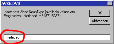

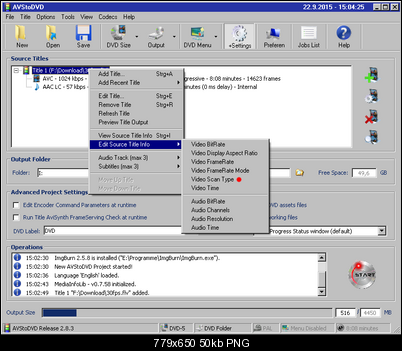

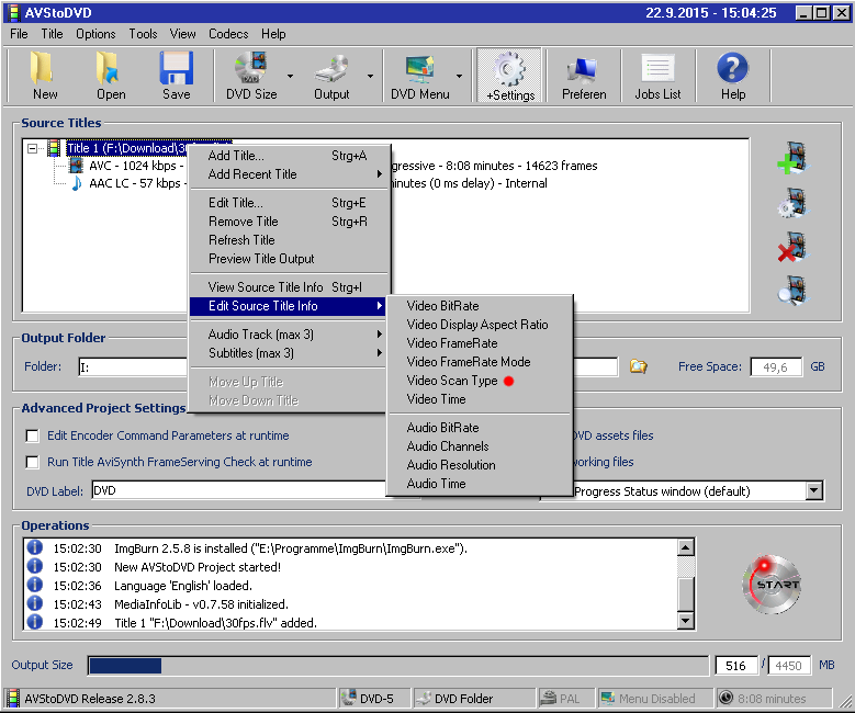

    No problem, here we go:
    Convert 30fps (or 29.97fps) progressive clips to 25fps interlaced in AVStoDVD
    This method provides smoother motion than just using ChangeFPS() because it drops fields instead of whole frames.
    Load your source file into AVStoDVD, edit the source title info (rightclick on the title). Change the Video Scan Type from Progressive to Interlaced.

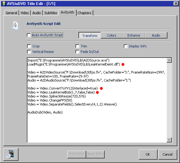

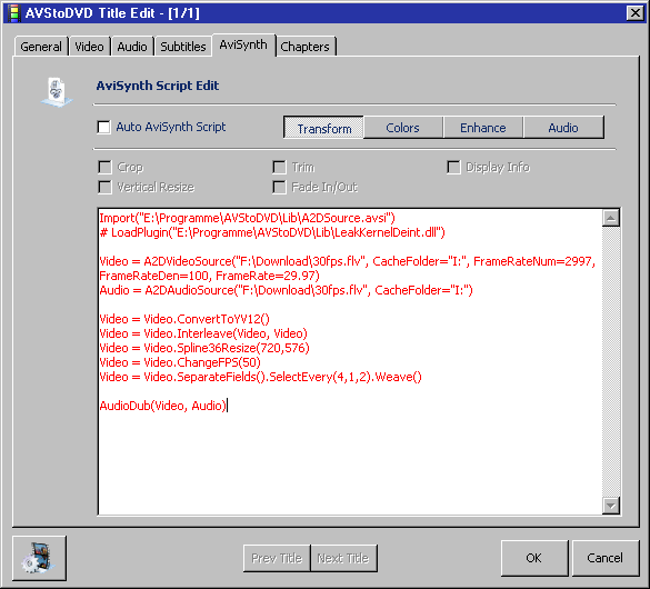

    Click "View/Edit Title Settings" and select the "AviSynth" tab. Uncheck "Auto AviSynth Script" and edit the script according to these screen shots:
    Before:
    After::
    Notes:
    1. Deactivating the "LoadPlugin()" command is optional, you can also leave it as it is.
    2. For the color conversion changing "interlaced=true" to "interlaced=false" has the same effect.
    3. You can speed up the script by putting the resizer command before the "Interleave(Video, Video)" command.
