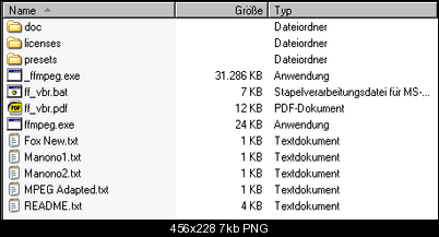

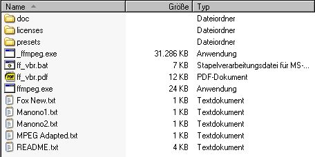

  8. Member manolito's Avatar
    Jun 2009
    Germany
    Sorry, I cannot reproduce the menu creation issue. Tried all kinds of different menues (static thumbnails, animated thumbnails) and a few different source files, no problems.
    I still suspect that ffmpeg_vbr is not installed correctly. After a correct installation your "AVStoDVD\FFMpeg" folder should look exactly like this:
    Please note the file sizes:
    ffmpeg.exe is 24 KB, _ffmpeg.exe is much larger.
    Cheers
    manolito
